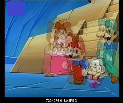

    However, I find it difficult to remove the ghost effect from the dvb-t captures of my tv-tuner card....
    Here is a screenshot:
Name:	mario 1.ts_snapshot_07.27_[2013.01.09_16.25.55].jpg
    I have tried several deinterlacers and programs to solve this but none seems to do the trick
    I prefer using MeGui, but any other software that works is welcome

  2. Have your tried sRestore and the typical Fieldblending and Frameblending removal-filters?
    sRestore(23.976) looks like a good start,...
    additionally I would crop to:
    Crop(24,0,678,570)
    than resize to:
    Spline16Resize(704,504)
    and encode with an NTSC 4:3 PAR
    Cu Selur
    Ps.: Your content is flagged top field first, but is really progressive.

    You really gave me great food for thought and experiment. So this originally was an ntsc video that was transformed into a pal video and the change in framerate created double frames (with a little help from the deinterlace filter that was used in this transcoding I suppose...)
    But what if I want to keep it a pal video? Then I am stuck with this ghost - double frame effect?

    The video is already 720x576. It looks originally progressive+telecine improperly re-encoded as interlaced. Not certain, though, because so many people are finding more creative ways to screw up video. The .ts was encoded at a miserly 2300 bitrate and mp2 audio (if you want this to go NTSC, mp2 won't work). Looks like this was part of a project that tried to stuff 4 hours of bad data-starved video onto 1 disc.
    If it was originally NTSC, it would have been film-based, 23.97 fps progressive with 3:2 pulldown for 29.97 fps playback, not interlaced. The 3:2 pulldown was not removed, so you have a field blend at regular cycles. Open the video in VirtualDub and move it one frame at a time, you'll see the blend cycle in frames where objects move.

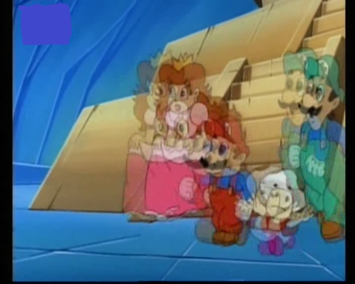

  8. Well... I've tried both your recommendations Selur but still I get videos with duplicates...
    In the first case the script looked like this:
    ColorMatrix(hints=true, threads=0)
    srestore(23.976)
    #deinterlace
    crop(28, 0, -22, -8)
    Spline16Resize(704,504) # Spline16 (Neutral)
    FluxSmoothST(7,7) # Medium Noise
    on the second:
    srestore(omode=3)
    #deinterlace
  9. What sRestore does is:

  10. well, I realise that I simply don't have the knowledge to remove the duplicates through srestore... But let me note this: Even newer cartoons/anime coming from my dvb-t captures have the same problem, so I really don't think it's the cartoon's age.
    Moreover, I see no difference in the number/frequency of duplicate frames after I use srestore It's like it has done nothing!
    Why don't you have a try on the file I posted to see if you can at least decrease the number of duplicates?
