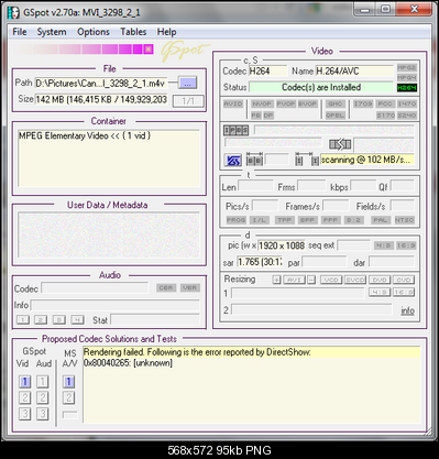

    I have the Canon Ixus 220HS which makes h264 1080p 23.976 videos which Id like to use in an authoring program like Adobe Encore. But it keeps transcoding it even though its exactly the same as the projects settings.
    Ive included a screenshot of Gspot of the original canon video:

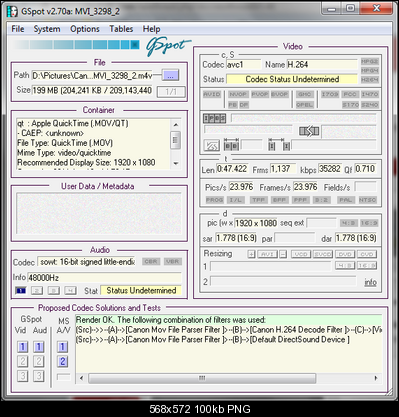

    And this is Gspot of the video re-encoded using the Adobe Encoder which makes the video compliant and doesnt need transcoding but as its been re-encoded, id like to avoid that:

    don't use gspot, it hasn't been updated in years. get and use mediainfo in text mode.

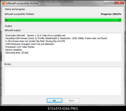

    I just demuxed with tsmuxer, but I dont think its doing the fps field properly. It says:
    When I import the video (no audio) to Encore it thinks its 25fps.
