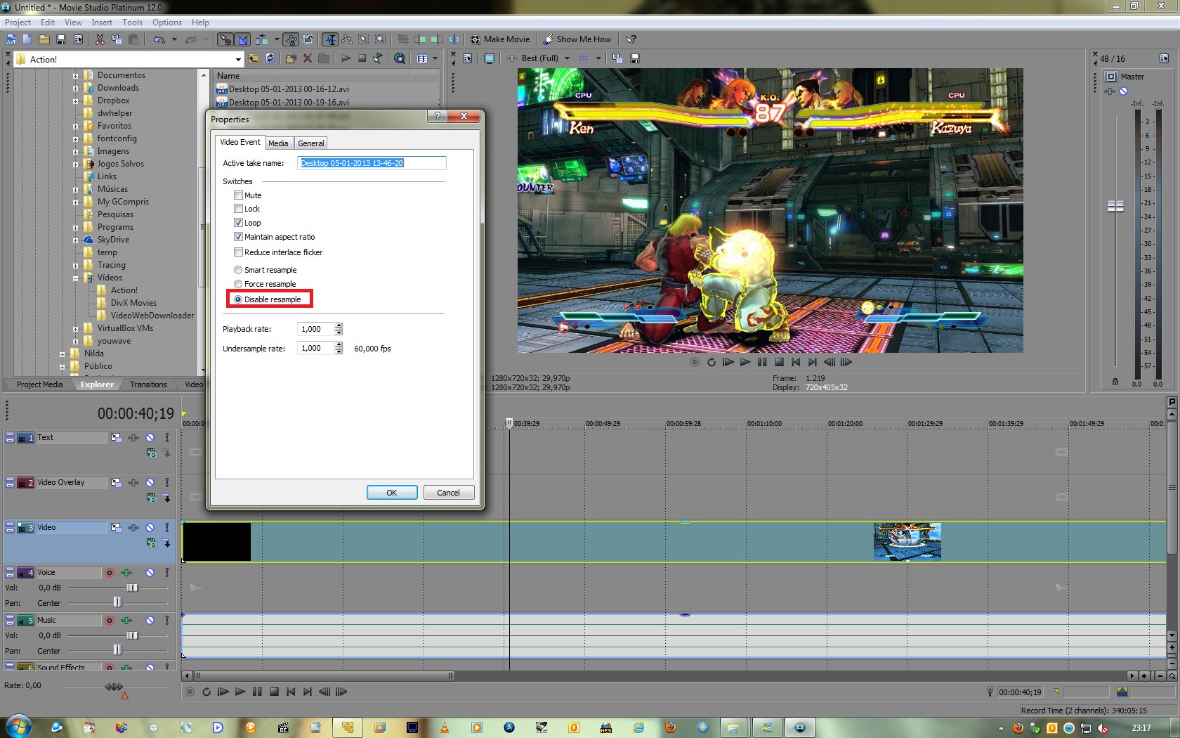

  4. Lone soldier Cauptain's Avatar
    Jan 2006
    Brazil

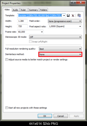

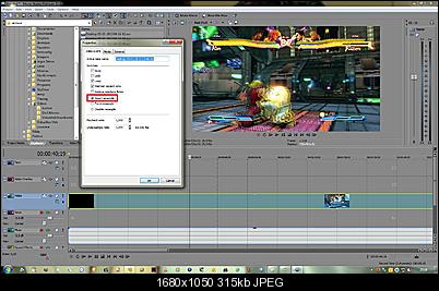

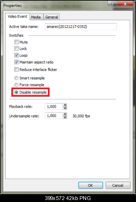

    Click button 2 in media file, properties and select this:

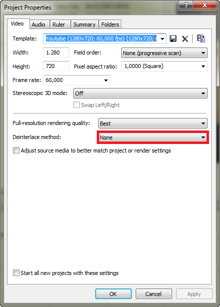

    In project mode, select this:
    Claudio
  5. As for deinterlace method, it should be there for interlace content, when Vegas makes progressive output from interlace it needs little help how to deinterlace, isn't it working like that? (interlace to web for example)
    If there is interlace to interlace encoding it should not matter what deinterlace method is, maybe it matters.
    If there is progressive to progressive , I'd set it to none too.
    I might be wrong that is how I feel it works.

    Deinterlace has no relation to resample.

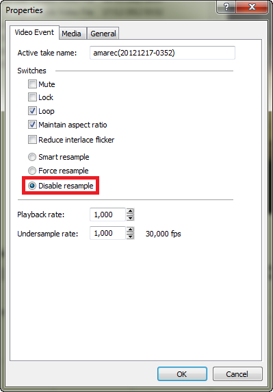

  8. Cauptain - yes, disable resample gets rid of ghosting, but I was referring to that second original picture of yours which showed deinterlace method set to none
  9. Thank you very much, everybody!
    Special thanks to Cauptain and budwzr.
    Turning off resampling does get rid of that ghosting issue for me, yes.
    (I was able to up the quality, roughly from a 9/10 to a 10/10, now, when compared to the quality of the initial file.)
    Excellent!

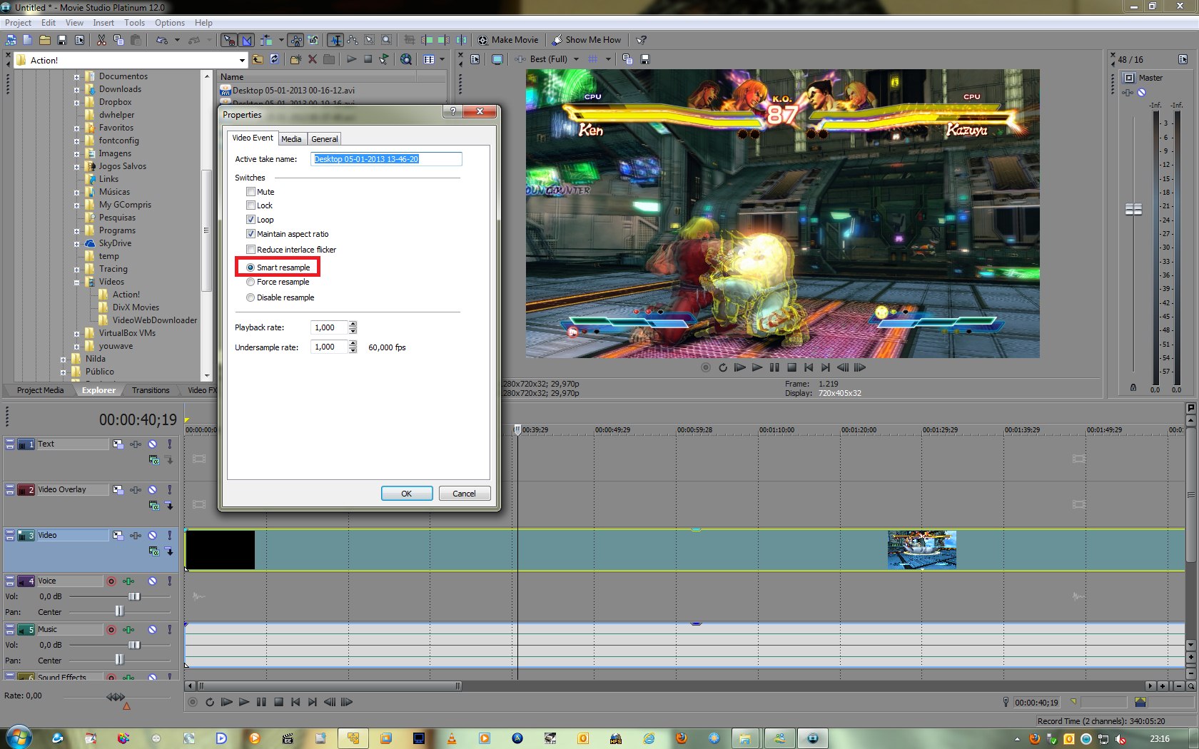

    Instead of going to the 'Video Event' tab, though, I right-clicked each video piece on the editing timeline, hovered over 'Switches' and selected 'Disable resample' there. (Before, it was on 'Smart resample'.)
    Same thing, right?

  14. But, hey, speaking of which, that 'Switches' move I did is the same as the 'Video Event' tab move, right? (- assuming I switched every single video piece of the edited file on the timeline, which I did)
    If that's the same, then I'm not worried.
    ...And I achieved what I was hoping to. (So, it's all good.)
