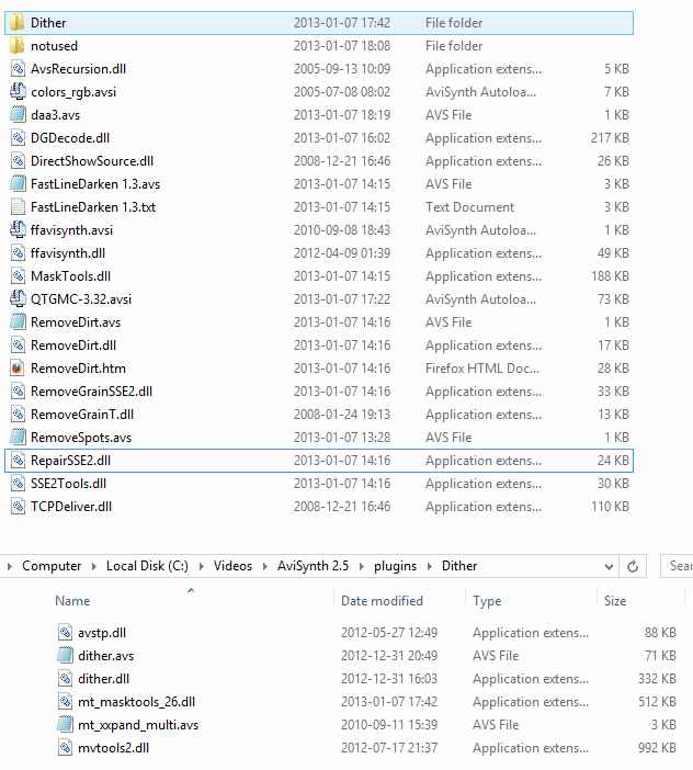

  15. You need masktools2. You have masktools1 (which is Masktool.dll)
    are you using avisynth 2.5.x or 2.6.x ?
    if you don't know, type version() at the end of a script and preview
    mt_masktools_26.dll is for avisynth 2.6.x => this is the one you have in the screenshot (but it's in the wrong folder)
    mt_masktools_25.dll is for avisynth 2.5.x

    You need masktools-v2. There are several versions of v2 (don'tcha luv it?), but v2.0a45 is the more useful, especially since QTGMC can use it for both YV12 and YUY2. v4.0a45 is a version for Avisynth 2.5.x, available here: http://manao4.free.fr/masktools-v2.0a45.zip. You can have the old Masktools.dll and the newer Masktools-25 dll in the same plugins folder, because the function names are different in each; however, some older plugins use the old v1, so you'll see scripts loading v1 manually.
    You have version 2.6 for Masktools in your plugins folder. This works for Avisynth 2.5x and 2.6x, but not all 2.5x plugins will work with the 2.6 dll. (Oh, man!). Some plugins for Avisynth 2.5 will use it, others won't. You'll note in the 2nd avs script that Dither.dll uses Masktools 2.6, not Masktools 2.5. The solution? Put the 2.5 Masktools dll in your plugins folder. Then create another plugins folder and call it plugins2. Put the Masktools 2.6 dll in plugins2, and load it explicitly in a script when you need that specific version. For now, MaskTools 2.5 is what most people are using most of the time.

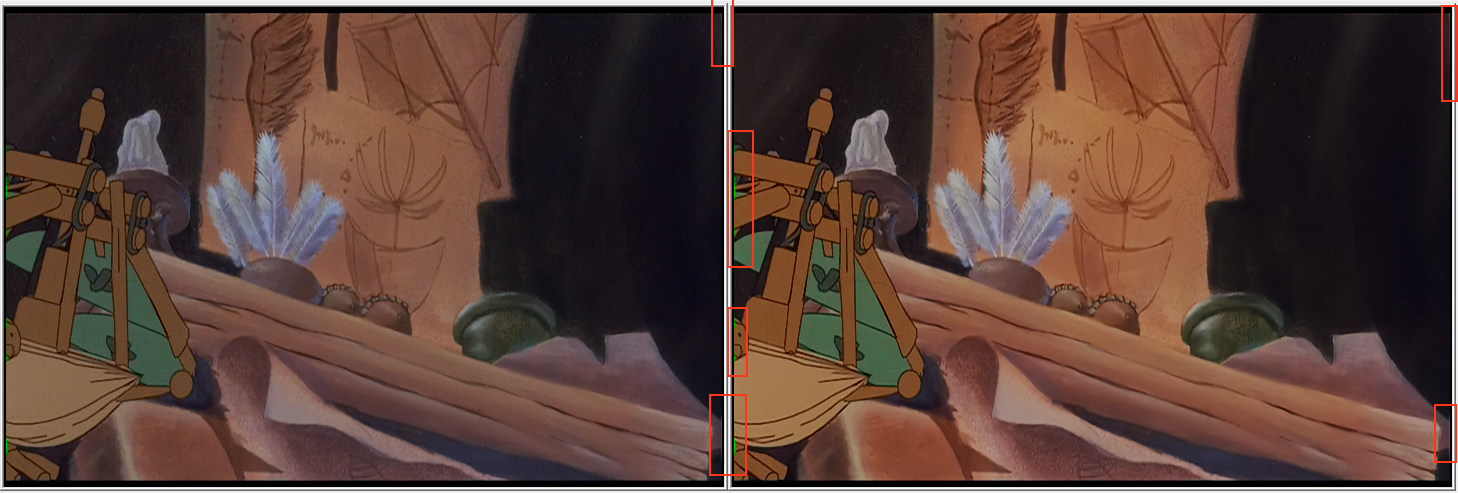

    I was able to see the actual image after disabling that line.
    I've opened the original d2v file and the script file and compare each videos, the one generated with avisynth have a little green bar on the right, the colors are fade and there is a quality loss.
    I think it's because I didn't convert the file to a lossless codec, is it possible?
    (Screenshots below)

    Meanwhile...."vidpath=" is just a string variable that I created to cut down some typing. You don't need it, it's not even an Avisynth term. I simply used vidpath just for the folder path to the video clip or d2v.
    The same goes for ppath, which just stands for "plugin path". Apparently your plugins are in C:\Videos\AviSynth 2.5\plugins. So you would use that ppath user-created variable to store the location of your plugins folder, with a "\" at the end of the string. The "+" in the statements below means "join the ppath text value with the following text." You would end up with:
    ppath="C:\Videos\AviSynth 2.5\plugins\"
    Import(ppath + "QTGMC-3.32.avsi")
    Import(ppath + "RemoveSpots.avs")
    Import(ppath + "DeBlock_QED.avs")
    Import(ppath + "daa3.avs")
    Import(ppath + "FastLineDarken 1.3.avs")
    But you don't have to do it that way. Your version worked just fine, so you don't need vidpath or ppath.

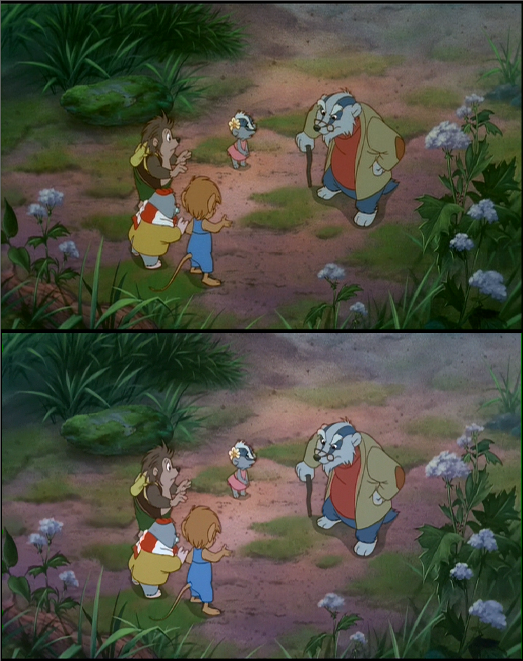

    Its... WORKING!
    But it still looks like a Jpeg file with high compression, on the left window... is it normal?
    And if I want it back to MKV after (to put all audio tracks and subs... I just need to go in File> Save as AVI (without any kind of configuration for codec) and then use mkvmerge ?

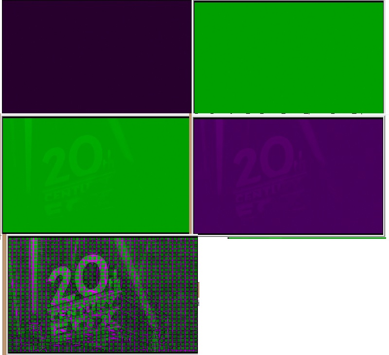

  30. Oops that'S true I forgot . Thanks though for the options settings...
    But just to make sure, I attached a printscreen showing green pixels around the borders.
    And check the quality of the image on the left, its like a jpeg lol.
    EDIT:
    For the compression, its RGB24 32 and I cant change it.
    The log tab on the work status shows that the format being used is RGB32. (See attached image for details)
    For the audio, no problem, I'm sure you'll give me a hand at that point
