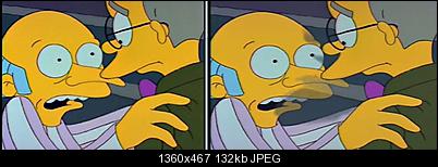

    So here's the same frame of the same scene...
    Picture left is MediaCoder, IVTC Primitive w/ "fast" Motion compensation
    Picture right is using either of the scripts provided.
    I do get dark spots using the settings in MediaCoder too (just not as pronounced or frequent) similar to using the provided AviSynth scripts. When I view the VOB in the same frames I can see and understand why the spots appear (probably no way to get rid of them entirely) as it has to do with some odd interlacing transparency during what appears to be a blended frame?
    I do have to give a nod to the AviSynth scripts producing a slightly cleaner image overall though when viewed in motion... but it's lost due to larger more pronouced dark spots.
    The AviSynth script also seems to produced a slightly out of ratio horizontal stretch too.
    hmmm... still thinking the pre-built settings in MediaCoder are winning the trials. Thoughts?

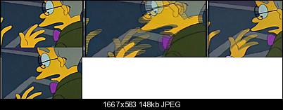

  14. One more example with VOB center...
    ----Left (top) *first field*
    ----Left (bottom) *second field* -- (MediaCoder, IVTC, Motion Compensation)
    ----Center VOB -- (ripped from DVD, no changes or filters, showing both first and second fields interlaced)
    ----Right -- (AviSynth scripts with "blended?" first and second fields??)
    Again, I do get some darkened areas when I use the MediaCoder settings too... just not as bad.
  15. Originally Posted by teknomedic View Post
    dark spots
    Was that frame in the samples you uploaded? I did see some problems where interlaced YV12 was mishandled by the previous encoding leading to blended chroma channels. It think that's the problem with the dark spots. You might try using SelectOdd() instead of SelectEven() in the second script. But it may just move the problem to different frames.
    When TFM() can't find complimentary fields it uses a blend deinterlace on the remain comb artifacts. If it doesn't see the comb artifacts (which sometimes happens with very small ones) VInverse() will blend them.
    You can add the argument "pp=0" to disable TFM's post processor. That way it won't attempt to remove the remaining comb artifacts. Also remove VInverse(). That will let you see combing from orphaned fields.

  18. The problem is in your source video. As I noted before, interlaced YV12 has interlaced chroma channels as well as an interlaced luma channel. Some program treated (or the video was improperly filtered) and the chroma channels were treated as if they were progressive. This has caused the colors from the two fields to blend together. I think it's just an accident that some processing sequences manage to eliminate more than others.
