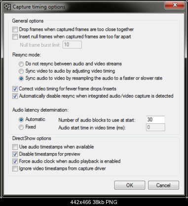

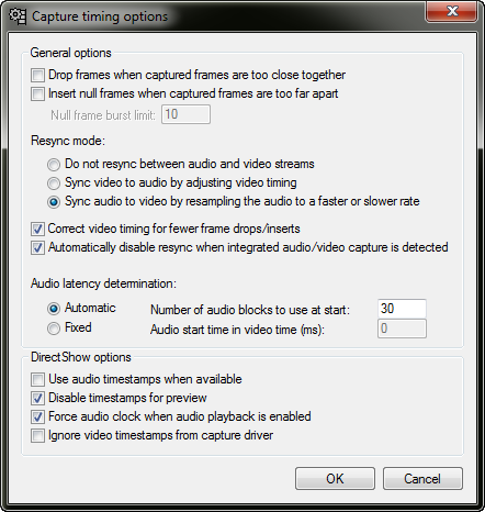

    Hi Avz10,
    Try other codec like UT VIDEO. If desync again,go to VD capture module and change TIMING options.
    Claudio
