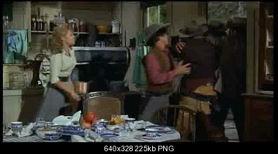

  7. Here's an example of what I'm seeing:
    Without deblocking:

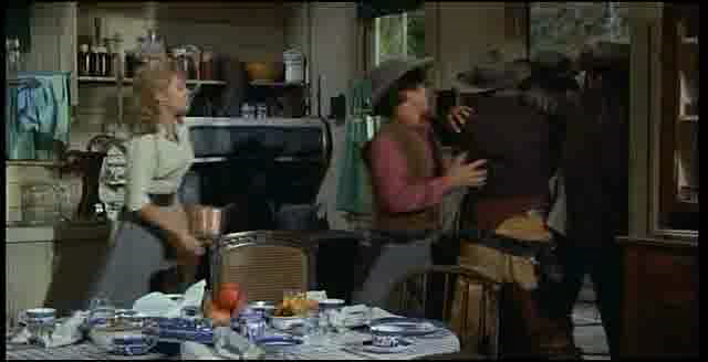

    VLC screencap (post processing = 6):
    I believe VLC's deblocking algorithm works on 8x8 blocks and that those blocks must be aligned on 8 pixel boundaries. If your video has been reencoded and cropped more than once the blocks may not be aligned any more. In which case the deblocking won't work as well.
