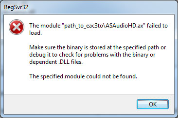

    Hi, Island_Dweller, I just tryed this but each time it says: "The specified path could not be found". If I did something whong, I don't know what... Do you think you can help me sort this ?
    UPDATE: Here's what happen when I paste the code in the CMD :Name:  errormessage_zpsec52f3aa.jpg
    So, what else now ?
    Aug 2010
    Indian Ocean
    As I said before:
    path_to_eac3to should be changed to your working eac3to folder.
    Mine is "D:\eac3to", so it would become regsvr32 "D:\eac3to\ASAudioHD.ax"
    Where is your eac3to folder located?
    for convenience, just copy the eac3to folder to the root of the C drive, then type the following in cmd.exe
    regsvr32 "C:\eac3to\ASAudioHD.ax"

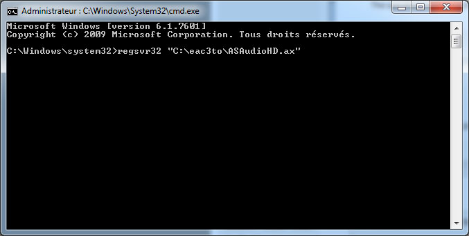

    Ok, I've copyed the eac3to folder in C:\Program Files (I think that's what you meant by "root of the C drive "). Then, I open CMD and add your code (copy/paste)
    No success here, still the same error message Any other ideas ?
  14. Originally Posted by monks19 View Post
    [Attachment 15528 - Click to enlarge]
    It's still the wrong path . Notice
    C:\eac3to
    is different than
    c:\Program Files\eac3to
    The "root" refers to C:\ , not C:\Program Files . Either change your commandline, or copy the eac3to folder to C:\

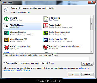

    Ok, it's been corrected. Now it's asking me to chooce a program in Windows to open ASAudioHD.ax. What do I chose ?
    Aug 2010
    Indian Ocean
    No, you don't need to open it, it simply needs to be added to your windows registry so Eac3to will recognize it.
    Where is the eac3to folder now? I recommend using C:\eac3to as it's more convenient.
    May 2006
    Canada

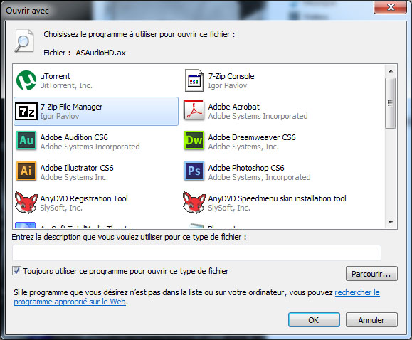

    It's in the C drive, now. But Windows is now asking me to chose a program to open the ASAudioHD.ax
    What do I do with that and what do I do next ?
  18. Member
    Aug 2010
    Indian Ocean
    So, typing
    in cmd results in windows asking you to choose a program to open the file? That is odd.
    I just tried this again on a win 7 x64 machine and it worked fine.

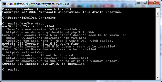

    The first thing you need to do is confirm that Eac3to is "seeing" the Arcsoft decoder.
    1) open cmd
    2) type cd C:\eac3to
    3) type eac3to -test
    If it says ArcSoft DTS Decoder works fine, then you can use HD-DVD/Blu-Ray Stream Extractor to get wavs files.
    Just select the dts-hd track, and under "extract as", choose WAVS.
  22. Member
    May 2006
    Canada
    Ok, I think this is it, now.
    Do I have to put HD-DVD/Blu-Ray Stream Extractor in the eac3to folder in order to work?
