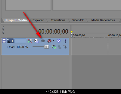

    are you using the track fx button?

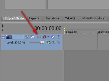

    Yes, unless you use the wrong TrackMotion. The one on the left is the correct one.

    There is a separate button for the parent called "parent track motion"
    When you have tracks parented , look under the track number and to the left, there will be new sets of buttons
