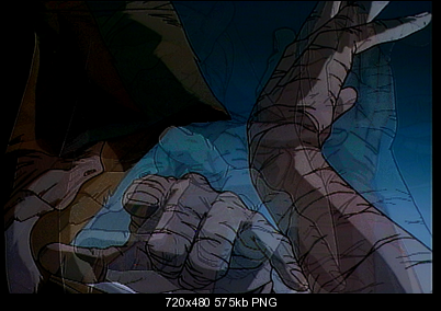

    Hello,
    I recently went back to buying LDs about 4 months ago after not buying a single disc since 2001 and become addicted once again. I bought a Hauppague USB-Live 2 so I could convert the rarer and most loved discs to DVD (using VirtualDub) but I am having a lot of trouble. When I playback a captured AVI, the colour seems a little off (like it is compressed with fewer colours, like old video clips in Mega-CD games but obviously not as bad) and I getting severe ghosting. It's almost like the colour is bleeding from frames with movement and creating the ghost. I tried different colour methods but it seems this crappy USB thingy can only do YUY2.
    I just realised that I have deleted the new tests I did earlier today so I will have to make a clip to upload. It is really frustrating me because having tried to do some research into the issue, "bad deinterlacing" keeps coming up as a cause. I am not using any de-interlacing when capturing though, unless I am missing a setting in VirtualDub? I just hope it is not something the Hauppague does automatically. I did try capturing with the ITVC filter on but it made no difference. Any help would be much appreciated! Thank you in advance.

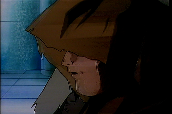

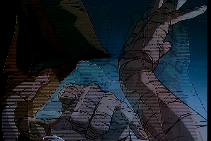

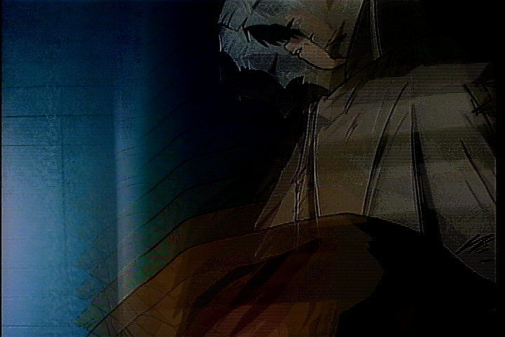

ID:	15495Click image for larger version
ID:	15496Click image for larger version
    I also took some screen shots.

    Wow. That's awful in your screenshots. The only things I know to do would be to try another capture program or buy a better Hauppauge device. If you must have USB their HD PVR devices are in the same family of chipsets as the Colossus and as long as your PC isn't ancient (check their recommended specs) you could get a lot better results with one of those or the Colossus. The Colossus has a TBC that you can turn on with a registry hack - not sure if the HD PVRs have this too or not. I think they do, but I'm not sure. You can search and find out.
  6. Turn off any temporal noise filters. You may need to use a third party utility. Maybe here:
    http://shspvr.com
    http://shspvr.com/tools.html

  17. The Hauppauge USB Live 2 is a decent card. The ghosting was caused by the device's temporal noise filter being cranked all the way up. And YUY2 isn't a bad thing. It's the closest color format to what's in an analog video signal. It's what you want to capture. Use the capture device's video proc amp settings to adjust levels and colors.
    One way to get at all the devices controls is to use GraphStudio. Add the capture filter then right click on it and select Properties. You can then run through the tabs and adjust all the settings. For real time feedback, you can do this "live" while previewing or capturing in another program.

    Ha, the noise filter is exactly what it was! How stupid do I feel for missing your first reply about that? It's a shame the noise filter causes problems because the picture looks so much better with it on. Even when using a noise remover plugin for post processing it gave some ghosting so I will just do it during the TMPEGenc process. I do know that YUY2 is the correct colour space for LD but I wanted to try others to see if I had the weird colour compression, just as a process of elimination. It seems that it was just another artifact from the noise reduction. Thank you again!
