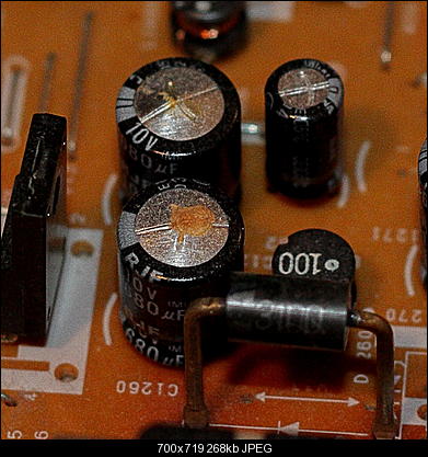

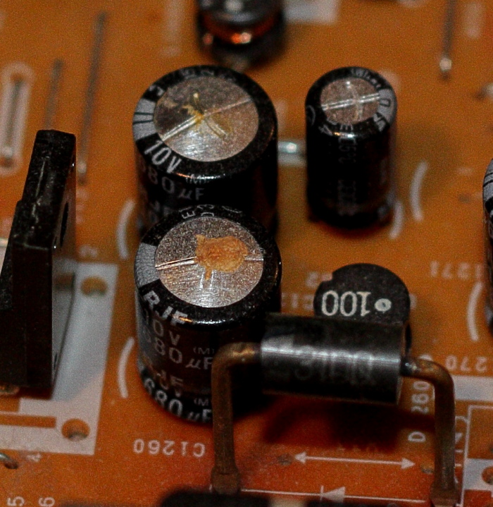

    Is this leakage around this big capacitor or solder flux? It's hard, not runny or gooey.

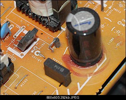

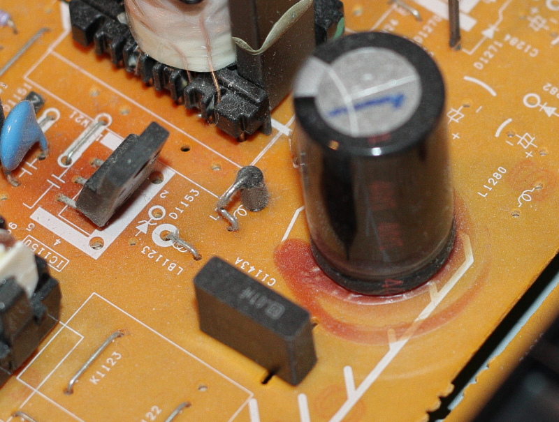

    Or is this the problem?

    Your lower photo, the upper is just the glue they use to hold the cap before it's soldered and also help it stay to the board better than just solder.
    The bottom photo is bad, both leaking(on top of cap) and bulging mean they should be replaced ASAP.
    Nice pictures BTW!

    Those ones in the bottom pic are definitely the problem. I'd replace any other large electrolytic caps on the power supply board too. They've all been in there the same length of time and you don't really want to be doing the job again on the others in a few months time.
