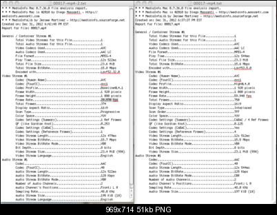

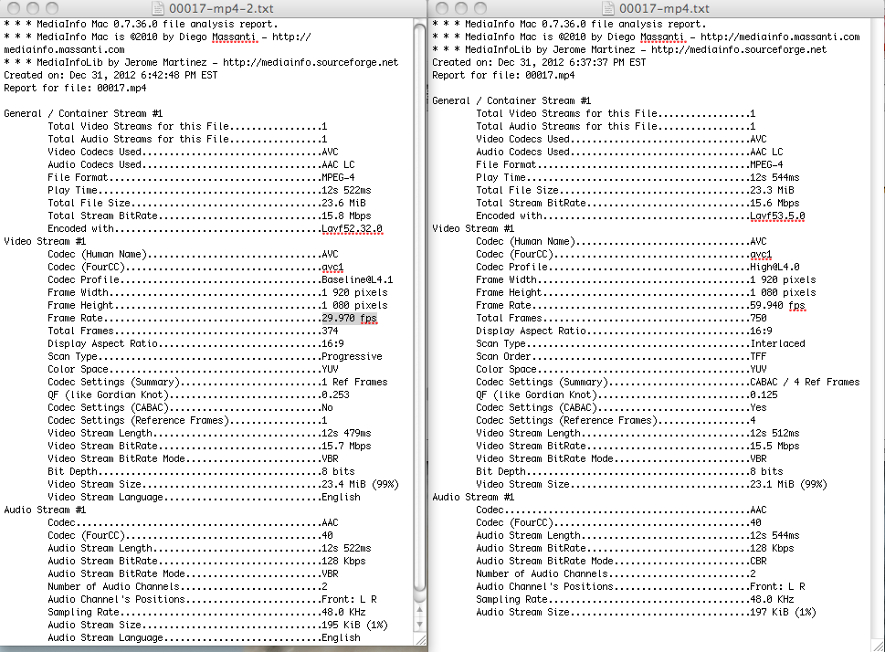

    Below I have attached a screencapture showing the info of the MP4 files. On the right side the original (remuxed as MP4), and on the left the one that is converted to MP4 (this is the one that gives me the good output)

  6. Your MTS file isn't 60 frames per second. It's 30 frames per second, interlaced. Each frame contains two fields, intended to be viewed seaparately, and sequentially, at 60 fields per second. The combination of deinterlacing, out-of-order processing, and maybe a problem with your remux, is causing the problem.
    Note that a nomenclature problem was created a few years ago by marketing gurus. One company started calling 30i video 60i (both are 30 frames per second, two fields per frame). Since one company started doing it all the others had to follow (or lose sales to what sounded twice as good). Then engineering was forced to change the file headers to indicate 60i instead of 30i so users wouldn't complain that such-and-such program reported their videos were 30i instead of the advertized 60i. So now there is much confusion on what these numbers mean. Both in the minds of the public and in software. Originally the number indicated the frame rate, the i/p indicated whether the frames were interlaced or progressive. 60i should mean 60 frames per second, interlaced, 120 fields per second. But it doesn't.
  7. The remux was probably using a ffmpeg based tool (they have problems with interlaced AVCHD transport streams, hence the error in frame rate)
    Try can try clipwrap , there is a free trial
