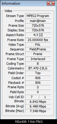

    I have Dragon Ball DVD Pal, I would like to encode my DVD
    For this, I ask an encoder for encode an extract but I can not to reproduce the same quality
    This is extract and the originals video : http://depositfiles.com/rmv/8936352114280811

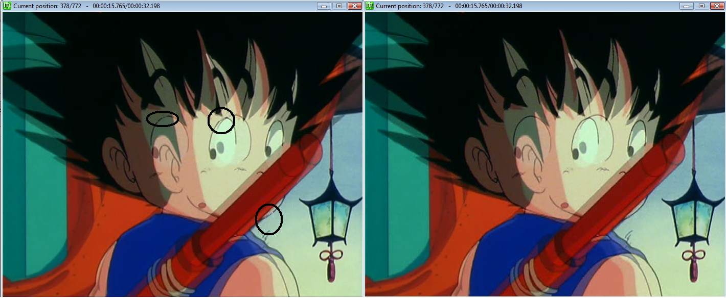

    Here is a picture with the difference difference between the two.
Name:	Yadif Vs QTGMC.png
    For the resolution, I want to do as the encodeur
  9. Yes, you spotted the main flaw when using Yadif - the aliasing you often get on diagonal and/or curved lines. If QTGMC is too slow, you can speed it up some by using a faster preset. 'Slower' is the default, but there are many other presets:
    "Placebo", "Very Slow", "Slower", "Slow", "Medium", "Fast", "Faster", "Very Fast", "Super Fast", "Ultra Fast", "Draft"
    But at some point you may see that aliasing begin to return. The included doc is very helpful and complete and is worth reading.

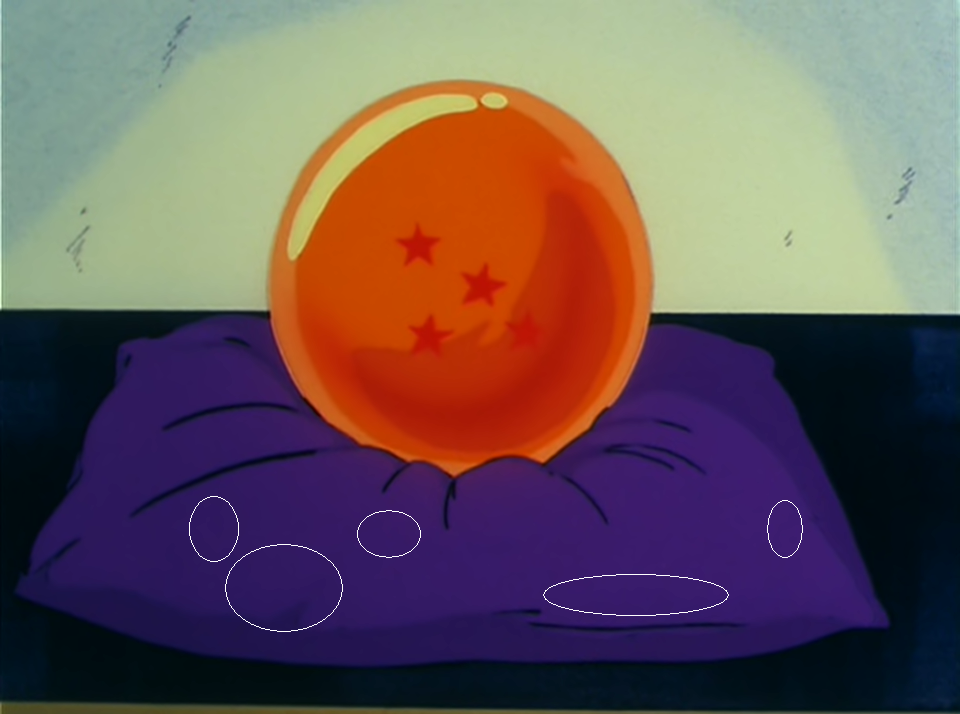

    Now, to clean the video I use dfttestMC() but the video is not clean. What is the problem ?

  11. You can use DFTTest from within QTGMC . I clean a lot of VHS tape captures and VCDs and often use something like this:
    QTGMC(Preset="Medium",NoiseProcess=1,NoiseRestore= 0,Denoiser="DFTTest",DenoiseMC=True,NoiseTR=2,Sigm a=12 )
    These temporal cleaners work over several frames by removing the junk that lasts only a single frame. If you have crap that extends over 2 or more frames, then it may not get removed, or removed entirely. I don't know if that's the case with your photos or not. In such cases you may have to go over the video frame-by-frame and add in a frame interpolator to create new frames for you by using the good frames on either side of the frames you want to replace.
    As long as you understand that TR2=3 results in some pretty strong smoothing, then your settings look good. I don't understand what you mean by not reproduce a color. Are you saying the colors change a little bit after using QTGMC?
