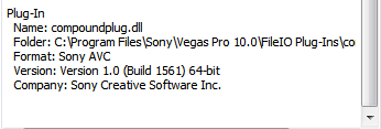

    pdr is probably referring to this. but how it can help i don't know as you can't open it in vegas to compare. maybe see if the plugin is there in the vegas subfolder.

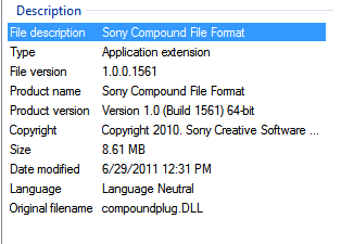

  10. aBigMeanie aedipuss's Avatar
    Oct 2005
    666th portal
    Originally Posted by lindenkron View Post
    The DLL file:
    File version 1.0.0.12.15
    Productversion 1.0 (Build 1215) 64-bit.
    Latest version ye?
    sorry for the late reply - been busy
    nope not the latest version of the .dll - you should have build 1561.
