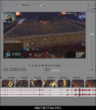

    if it's not too large upload it so it can be looked at. i downloaded a couple from there and they work in vegas ok. they use variable frame rate so audio sync is a problem. you might use something like mediacoder to encode the video to a lossless format constant framerate video first and use that in vegas.

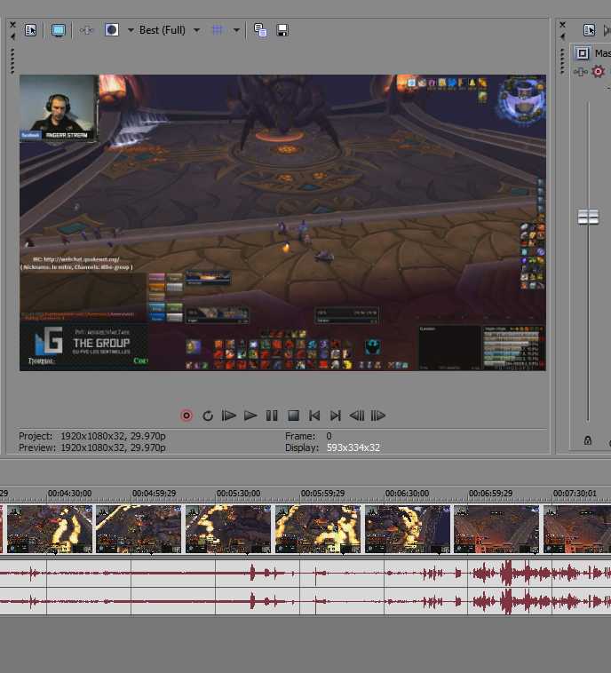

    They are pretty large 1 hour long ones.
    But it looks like you can drag/drop the .mp4 files into your Sony Vegas? So there's hope... something is just wrong... I wonder what. I get the standard "None of the files dropped on Vegas Pro could be opened." or the "Warning: An error occurred while opening one or more files. The file is most likely corrupted or of an unknown format." when trying to directly import it.

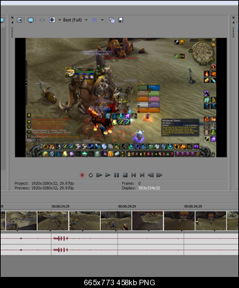

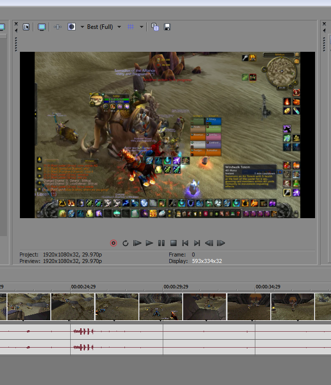

  10. aBigMeanie aedipuss's Avatar
    Oct 2005
    666th portal
    it seems corrupt and crashes some programs but mediacoder will accept it. i converted to huffyuv lossless and can import to vegas. only problem is your 30mb sample converts to 1.6gb. you could choose some other codec to convert to.

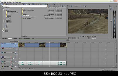

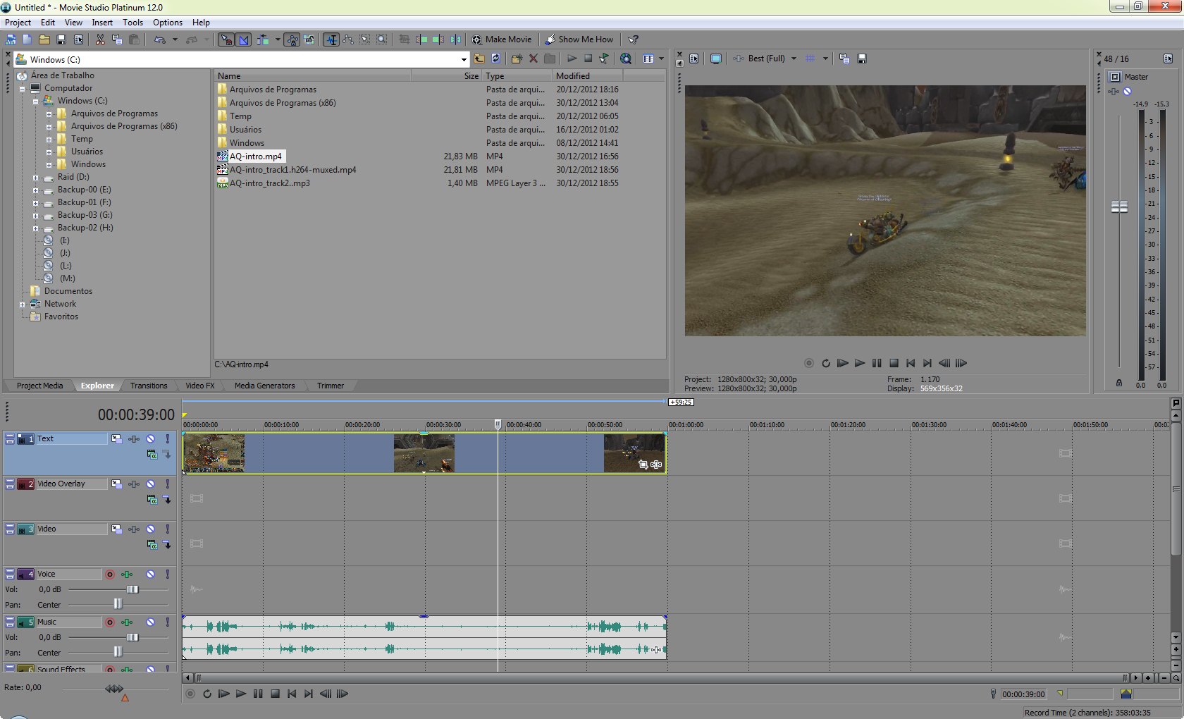

  22. Lone soldier Cauptain's Avatar
    Jan 2006
    Brazil
    did you download the sample he posted. it doesn't open in vegas.
    Using My MP4Box GUI to demux and mux again (40 seconds only), video work in Vegas, audio no. Only use audio demuxed to work hehehe.
