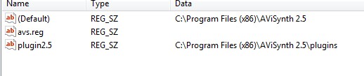

  2. Make sure you download and install AviSynth yourself. Don't rely on an AviSynth version included with some other software. Make sure you have these registry settings:

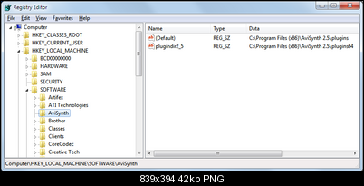

    I have Windows 7 64 bit;AviSynth installed the registry settings in a different location:

  6. I have those in the Registry too. The OP should try both.

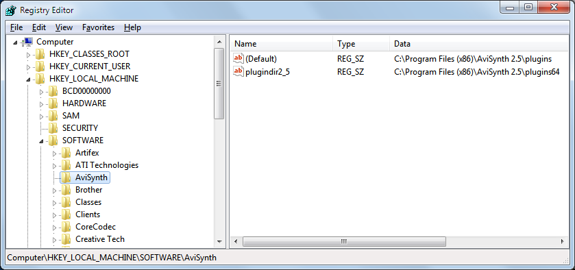

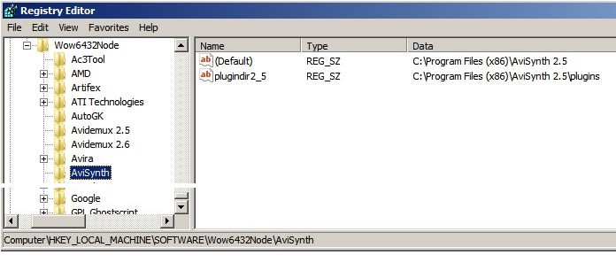

    Ugh I tried both Registry entries - - I still get the same message "There is no function called yadif etc". Here is what I wrote in the Registry as per instructions above.
    I have checked all the pathways - no typos there.

    I made a special KEY(?) called "AviSynth" and placed it in HKEY_LOCAL_MACHINE > SOFTWARE
    but it won't work.

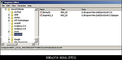

  9. Yadif is a special case. It doesn't autoload. It must be loaded in your script with Load_Stdcall_plugin().
    I just checked and sambat is right. 32 bit AviSynth under 64 Bit Win7 uses the settings in the Wow6432Node section. Here's the .REG file (in .ZIP). You should extract the .REG and double click on it.
