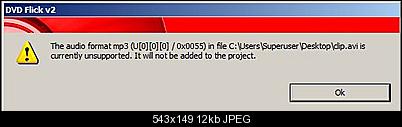

  6. Originally Posted by Calidore View Post
    However, ffmpeg has changed a great deal in the past couple of years, including many command syntaxes, and I'd be surprised if any older program could work properly with a new ffmpeg
    Sadly that is true. I have therefore modified DVD Flick slightly to integrate a recent ffmpeg build into DVD Flick. The result can be found here: https://sourceforge.net/projects/dvdflick-v2/
    For me the speed is much better now, more file formats are supported. I am also looking into adding a 2pass mode which should improve quality a lot.
    Dec 2005
    Canada
    Not in my case.
  8. sambat, I suggest following Calidore's advice to use a utility like Avanti to strip the audio out of problem video files and convert them to PCM/WAV (.wmv files) or AAC (almost everything else). It only takes a minute, then you go back to DVDflick and under the Edit File option choose Audio, then Add Audio Track. Select the "normalized" audio track you just created, and add it. DVDflick will then convert the video+audio into a DVD along with the other less-troublesome videos in your project.
    The only issue I encounter with the Avanti trick is when the stripped and normalized audio track has a length slightly longer than the video. To some degree this can be compensated by clicking the "ignore audio delay" checkbox for that audio track in DVDflick, and/or choosing "no menu" in the DVDflick authoring panel. In rare cases, I encounter odd audio formatting in some MP4s that DVDflick does accept but then spends 9 hours converting. When I strip the audio aut of those files with a utility, the running time is often 40% longer than the video, which likely causes the hangup. Such videos usually benefit from total combined re-encoding in something like MKVtools, prior to importing them into DVDflick.
