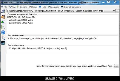

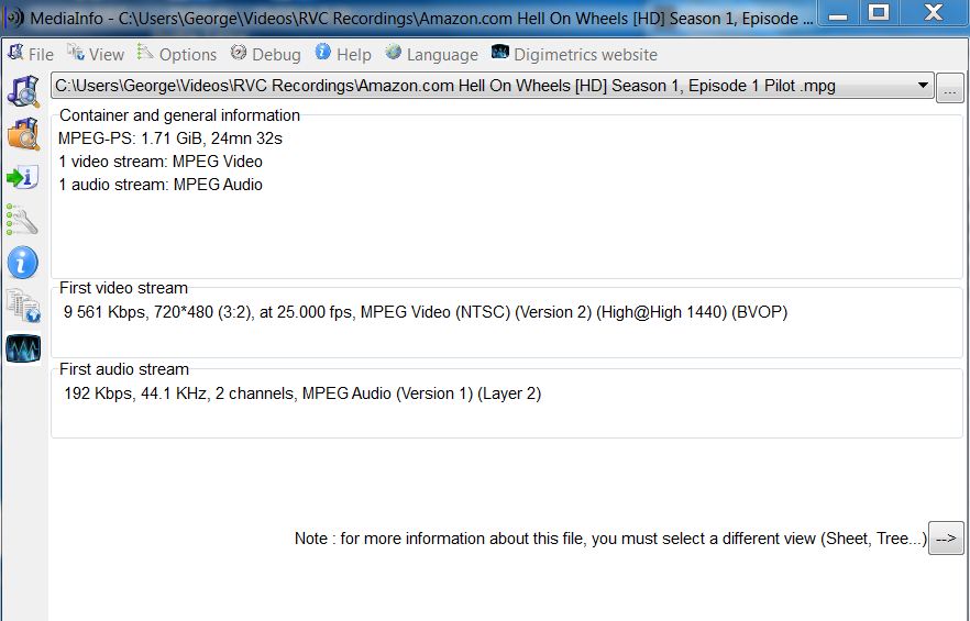

    Can you post the details from the mpg? Use mediainfo, open mpg, view->text.
    Jan 2007
Name:	Capture media info.JPG
