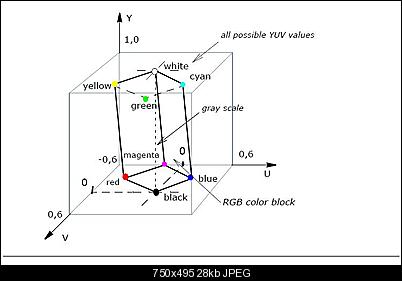

    8bit Y'CbCr can contain a lot more data than 8bit RGB. Look at this color cube representation . Notice the RGB cube is small and entirely fits within Y'CbCr space. Not all Y'CbCr values can be "mapped" to RGB (ie. you can't see some values because they lie outside the cube) . Wide gamut RGB is a standard to display more colors . Previously "illegal" or out of range (negative) values when using Rec601 or 709 can be visualized using Rec.1361 - that's all. Nothing else is changed. YCbCr is YCbCr. Lossless is lossless
    source: http://software.intel.com/sites/products/documentation/hpc/ipp/ippi/ippi_ch6/ch6_color_models.html

    okay, but has a 12bpp XV.color AVCHD video wider gamut than the 8bit simple RGB video? Can a 12bpp planar setting of FFV1 codec reserve its full color range? Or the 32/24bit settings of FFV1 can preserve the original colors?
  10. Originally Posted by Stears555 View Post
    YCbCr will potentially always have wider gamut than RGB at the same bit depth . Just because it "potentially" has more doesn't mean all those color values are necessarily used . Even if you have xvYCC proper recoding AND decoding matrix with hardware - but record a dull, drab scene, or even something like black and white chart, values might not be out of range even with Rec601 or 709.
    12bpp is same thing as 8bits per channel , but the CbCr planes are subsampled (they are reduced in resolution w:h). Reducing chroma resolution does not affect gamut (at least not directly)
    Even 12bpp "normal" video potentially has wider gamut than 8bit RGB (look at the color cube chart)
