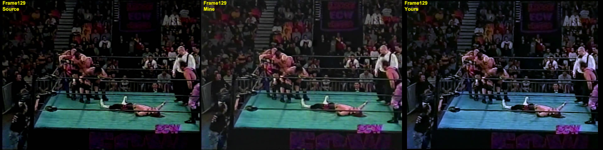

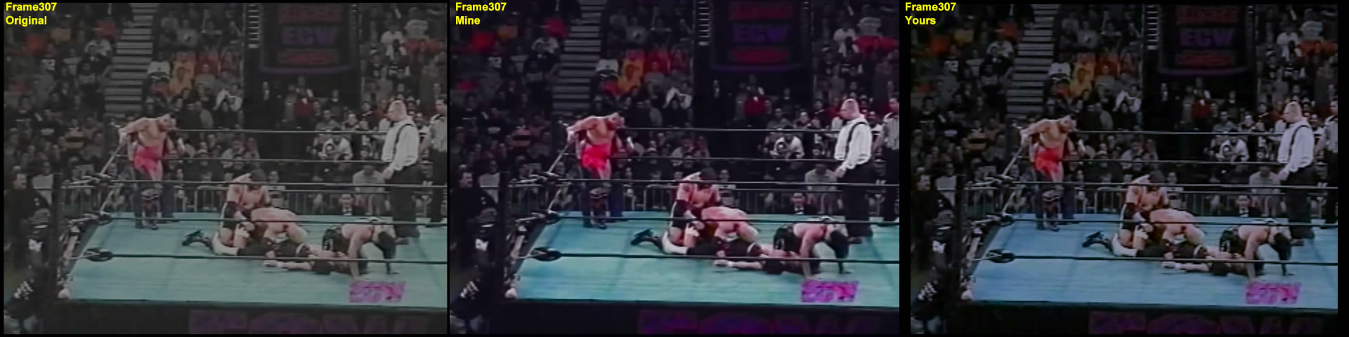

  7. Originally Posted by VideoFanatic View Post
    It doesn't look quite right.
    You're joking, right? The source is pretty messed up, but if mine 'doesn't look quite right', yours looks 'quite wrong'.
    Of course, there are some 'artistic' decisions to be made, and if you like the mat to be blue rather than the source's blue-green, then fine. But in your second half the contrast is way too low. Also, I think you tried to keep the original black levels (perhaps to be fixed later), judging by the 'Coring=False' you added to your Tweak settings, but in your conversions to RGB and back you wound up clipping them anyway.

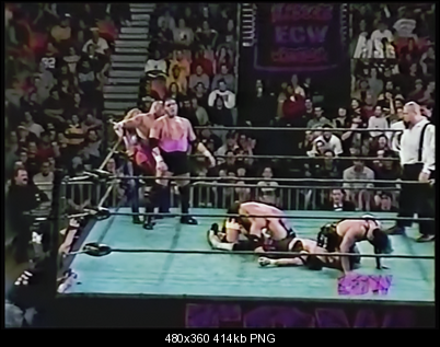

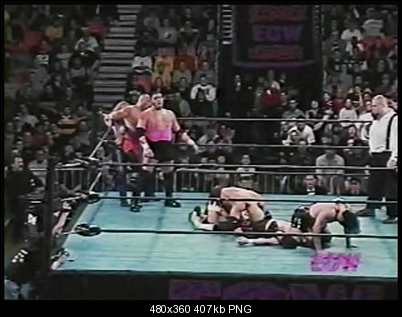

  8. Banned
    New York, US
    It doesn't look quite right. Here's what I've done so far:
    filtered=Tweak(Hue=-10, Sat=1.0, Bright=10, Cont=1.0, Coring=False) ReplaceFramesSimple(last,filtered,Mappings="[0 246]")
    filtered=ConvertToRGB32(interlaced=true). RGBAdjust(1.0, 1.0, 1.3). converttoyv12(interlaced=true) ReplaceFramesSimple(last,filtered,Mappings="[0 246]")
    filtered=Tweak(Hue=-10, Sat=1.5, Bright=-30, Cont=1.2, Coring=False) ReplaceFramesSimple(last,filtered,Mappings="[247 395]")
    filtered=ConvertToRGB32(interlaced=true). RGBAdjust(1.0, 1.0, 1.2). converttoyv12(interlaced=true) ReplaceFramesSimple(last,filtered,Mappings="[247 395]").....
    But as you can see there still seems to be a brightness haze on the 2nd part of the video.
    Can't say you aren't trying, anyway, although the steps taken here won't correct the bright part or or the "tint" problem. Any kind of histogram would tell you where the "haze" is coming from and what the color imbalance is, as well as the fact that the imbalance is not linear across the spectrum. Also, no one seems to have noticed that in the original source, frames 245 and 246 are duplicated as frames 247 and 248. The join at frame 247 is with a piece of video having different videos and a slightly different viewing perspective.
    Likely there's no way to make an exact levels or colors match. The washed-out clip that was joined is apparently from, a different tape, not with just zero contrast but with a totally different color balance. Both sections have oversaturated but extremely uneven Reds (so saturated, it's bleeding red badly), and too much midrange blue -- so adding more blue and leaving Red overcooked doesn't solve the problem.
    Re-worked frames 244 and 245 (I deleted the 2 duped frames). Skin tones are similar in both frames, but look how far out of whack the extremes are. Blacks in the early part of the clip are crushed, brights in the latter part were clipped long before it was joined to the first part.
    Used ColorYUV for the basic levels and color balance, then tweaked considerably in VirtualDub...but more RGB tweaking definitely needed.

  22. It's not so much aliasing I see but shimmering on the ropes. I tried this but I still see it:
    McTemporalDenoise(settings="medium", interlaced=true)
    AssumeTFF()
    QTGMC(Preset="Super Fast")
    Vinverse() SeparateFields() SelectEvery(4,0,3) Weave()
