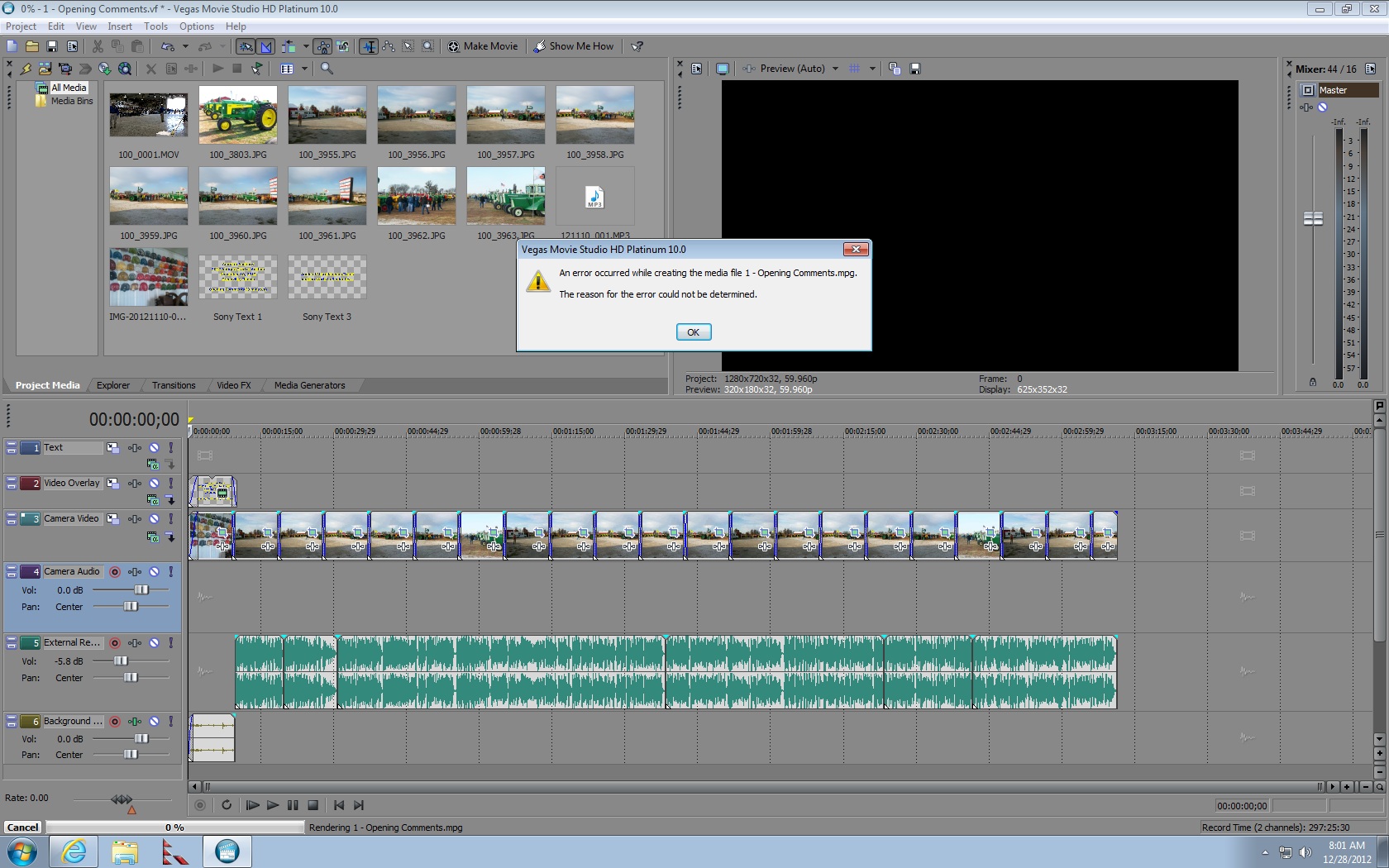

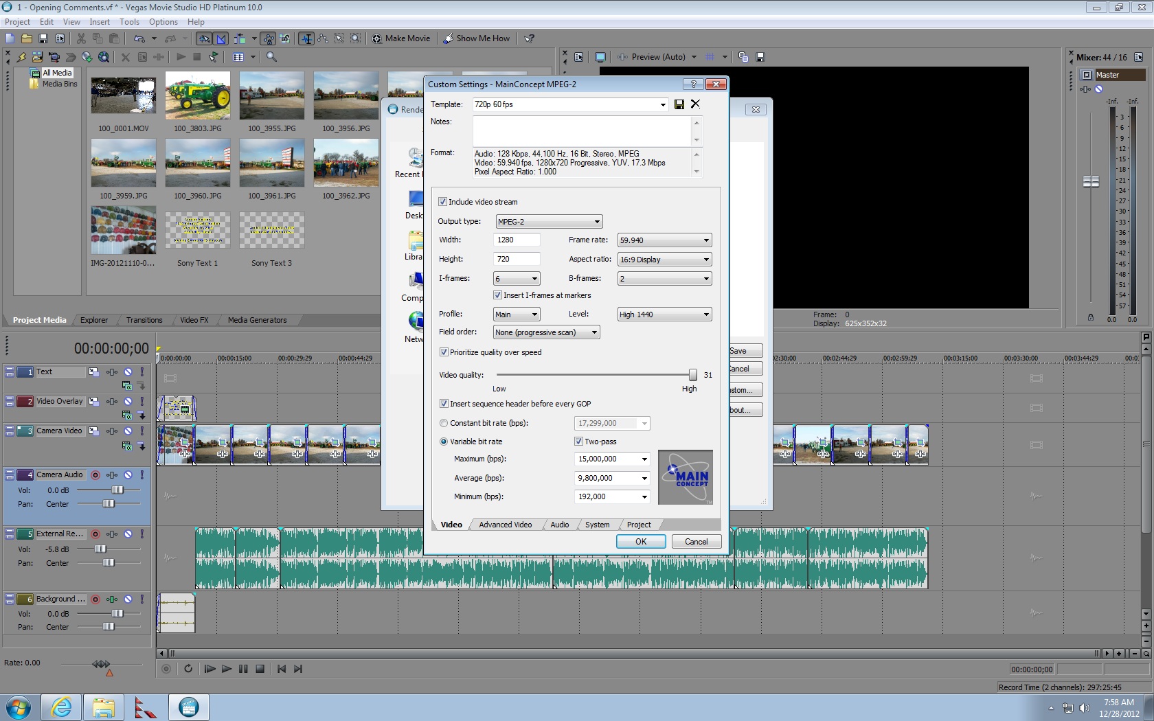

    I edited my source MOV files, setting Vegas' properties to match source (720p and 59.96 fps - note slight difference from 59.94 fps). The first segment is 3 minutes long and is still pictures with audio in the background. I couldn't find a 720p 59.94 fps render setting in Vegas, so I created a custom template (screen shot attached). When I try to render, I get an error message about an unknown error (see attached screen shot). Anybody know why this error is happening?
Name:	Vegas Render Screen.jpg
Name:	Vegas Render Error Message.jpg
  8. Originally Posted by 70Standard View Post
    Change the level to High, blu-ray doesn't use level High 1440.

  9. Member Cornucopia's Avatar
    You don't say how long your piece is, but your shot of your encode shows AVG bitrate of 9.8Mbps for MPEG2 HD, which is LOW. That's like 6 HOURS! Unless your clip is close to that long, you are seriously under-valuing your bitrate. Also, while it may have a few more "glitches" in encoding compatibility than MPEG2, AVC is MUCH more efficient, giving you a MUCH better picture for that same bitrate. Combine those to things, and you would probably find that your quality would greatly improve.
