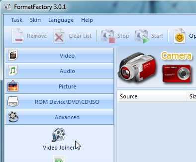

    I played with Format Factory a little and found a 'Workaround' since it does as you say about subtitles when you use the DVD function. If you select the advanced button instead of the dvd on left, then select File Joiner.

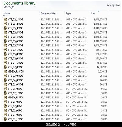

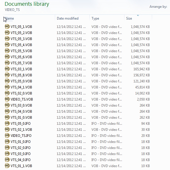

    Now select all the group of VOB files that are large. In mine for transformers it is the VTS_05_x.vob files:
Name:	ScreenHunter_460 Jan. 06 03.13.jpg

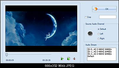

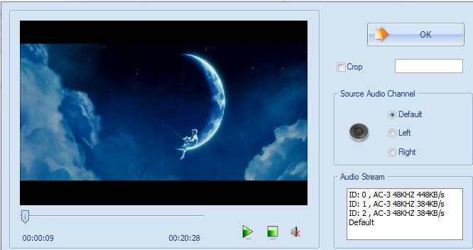

    These are the files the dvd function was going to choose anyway. If you need to view them to find the start of the movie, drag one to Format factory and then right click the file name and choose options. A screen opens and begins to play your movie.
    Name:  ScreenHunter_460 Jan. 06 03.33.jpg
Size:  22.4 KBClick image for larger version
Name:	ScreenHunter_460 Jan. 06 03.34.jpg
    Once you know which group has your movie (Usually the large file size ones) remove the vob file and select video joiner again. Pull them all over to Format factory and make sure they are in order(click Source tab at top of list to sort). Right click joiner line to select output settings. When you click start it should start to convert. I only did 2 VOB files to test and it didn't take too long but if the list is longer it make take longer.
