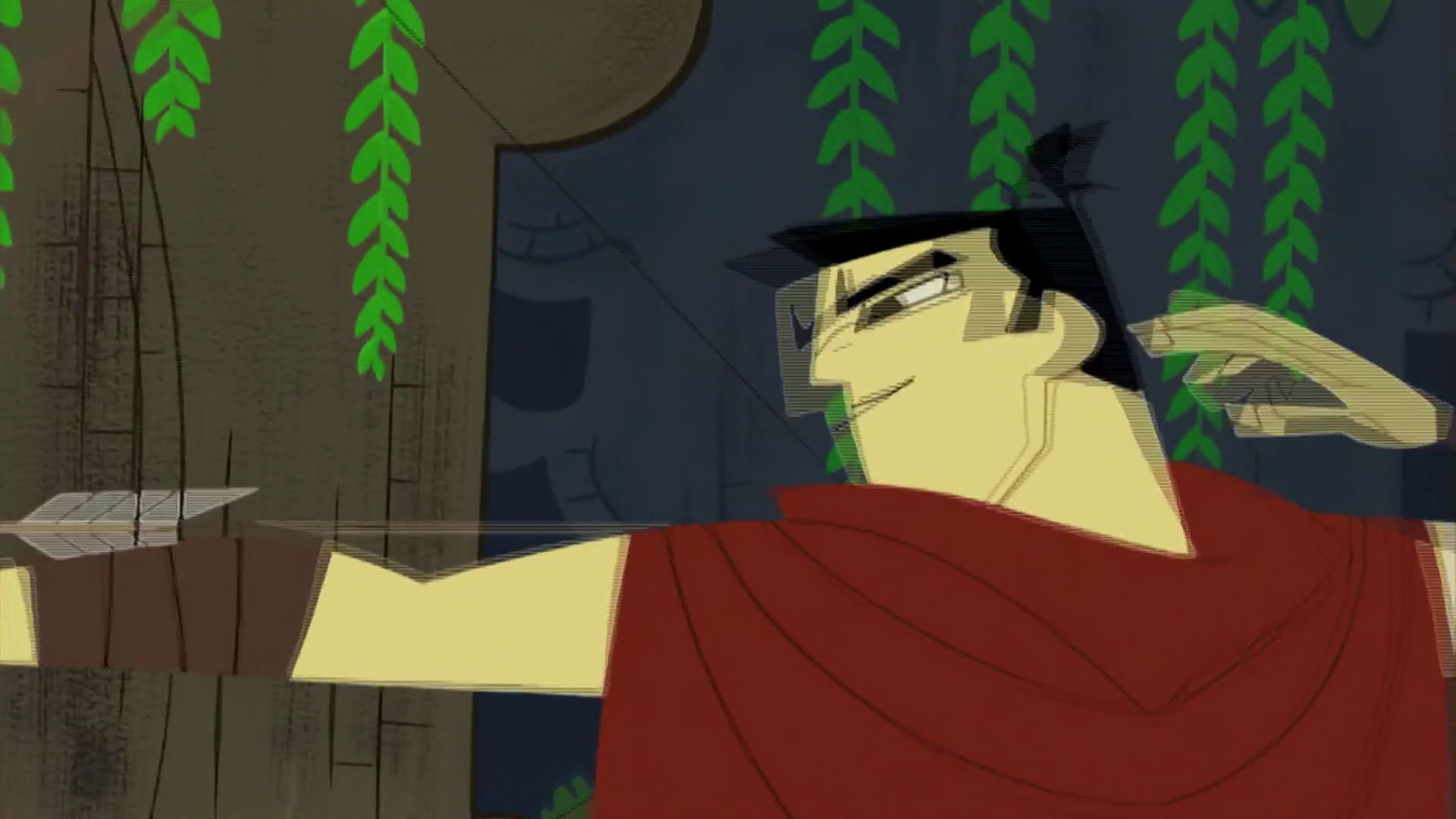

  1. I am trying to remove interlace line artifacts that occurs during fast motion in animation mpeg file. I use Video Mastering works (formerly Tmpgenc) and have tried following settings:
    Video Original frame rate: 23.976fps interlaced
    Video Mastering Works Deinterlace Filter Settings:
    Deinterlace mode: Deinterlace Always (double the Frame)
    Deinterlace method: inverse pull-down(reinforce anti-stripe)
    Output file format:
    Mp4 AVC - 59.94 fps Constant bit rate
    However as can be seen in the attached image when there is fast motion the lines become visible.
    I hope I am on the right track and these are interlacing issue.

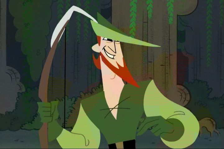

  4. That's pretty much straight 3:2 pulldown. The Inverse Pulldown method should work and give you 23.976 fps progressive frames. I seen to recall that function didn't work very well in the older version of TMPGEnc. And the video does have a problem where the chroma channels were mishandled so you will sometimes get a big of blended colors:
