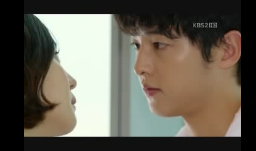

    thats the video it quite good

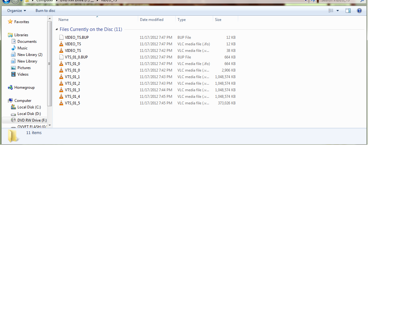

    thats the files in a dvd i want to that but i think it is more difficult because i converted all my files to avi and if i convert it to vob i think i spend a lot of time

    thats the contents
  7. If your player plays your AVI files just burn a data DVD with them. That will be much faster and simpler than converting to movie DVD. And you won't lose any quality.
