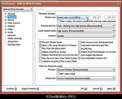

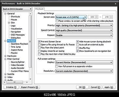

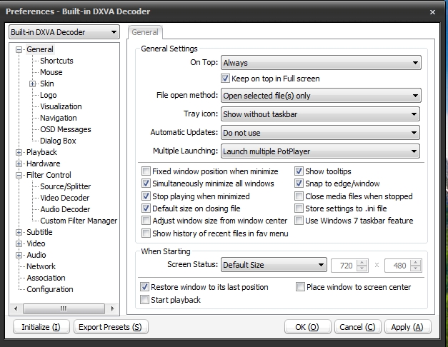

    I t took me a while also to get it right but there are 3 main screens to set up in preferences (F5) in order to get it to resize to video resolution. These settings I also set to go to default size on open and stop so it shrinks down out of the way. If you want it to stay the same size just hit hte pla/pause button to stop in mid-stream.
Name:	ScreenHunter_449 Dec. 23 00.47.jpg

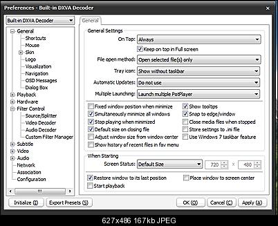

    You don't have to select keep on top but I like mine to stay on top. The same for launch multiple players but I like to use more than one to compare quality settings sometimes. Snap to edge means it willsnap to top and side of screen if you more it close. I set When starting to default size also.

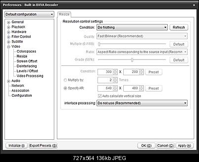

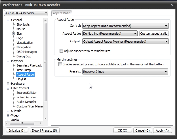

Name:	ScreenHunter_450 Dec. 23 00.47.jpg
    This screen size x1.0 100% was hard to find but is necessary for getting the resolution right. The other settings are you choice.
Name:	ScreenHunter_450 Dec. 23 00.48.jpg
    Aspect ratio shuld be set as above. Set this way my potplayer starts out at the video resolution and is adjustable but always maintains aspect ratio. Give it a try.

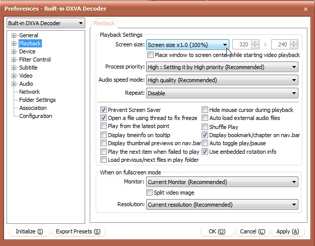

  4. Member Budman1's Avatar
    Jul 2012
    NORTHWEST ILLINOIS, USA

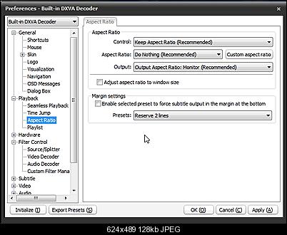

    OOps, my bad... forgot an important setting.
Name:	ScreenHunter_450 Dec. 23 20.28.jpg
    I reset all my settings and set just these and the ones in my earlier post and it plays with the video size equal to the resolution of the
    video and when I hit stiop it goes back to the 320x240 default size. Pause stays at video resolution size. I will add that for some reason, I change the settings and they do not change after I hit apply so I always close and reopen and check again to be sure. Also, some settings do not change until the Player is closed and reopened. I hope this helps.
  5. That did it! THANK YOU so much! I hope this helps others in the future as well.

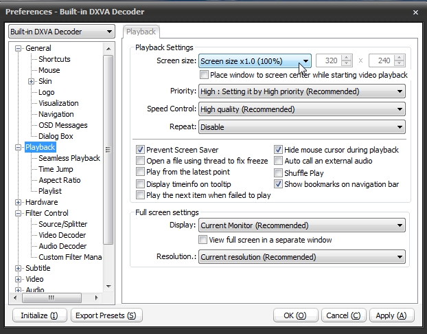

    I think you've used Window, Windows size, Screen and whole video interchangeably and they mean different things I believe. It sounds, to me anyway, like you have a DISPLAY with a RESOLUTION of 1920x1080 (for example) and you are trying to play a video with a resolution (Size) of say 2496x1404. PotPlayer normally stops at the screen resolution and actually displays the video on the Monitor as a 1920x1080 size video. Are you trying to display the video as if it is zoomed in to the center 1920x1080 and have the rest of the video off the screen?
    Either way set the setting below indicated by arrow to 1.0 100% to not zoom in or Full SIZE to have to go off screen:
Name:	ScreenHunter_55 Jan. 26 10.20.jpg

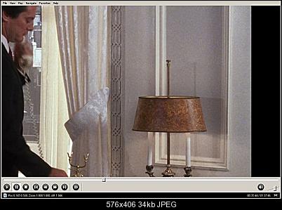

  10. Rather than make the Potplayer window match the video size, which I find monumentally annoying when it's wider than the screen, you could try this.....

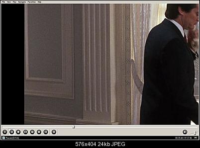

    I use MPC-HC and it seems to do the same thing.... the maximum window size is the size of the display, I can't seem to get it to do what VLC does and extend off the end of the screen.... which is unbelievably annoying anyway. However as huge chunks of Potplayer seem to be a MPC-HC rip off it'll probably have the same function. If you're at the stage where you've fiddled with settings enough to get the video to display at it's native resolution so you're only seeing a portion of it, rather than move the window around to see the rest of the video as you would with VLC, try moving the video around within the window. I assume that's the goal, to be able to look at the rest of the video in it's native resolution?
    If so, the keys on the numeric keypad do the resizing and stretching for MPC-HC (the 5 key resets everything), but CTRL+"the numeric keys" moves the video left and right, up and down etc. So the Potplayer window would stay maximised while the video moves around within. Hopefully that'll work. If Potplayer doesn't use the same keyboard shortcuts by default as MPC-HC, and I'd be surprised if it doesn't, it should list the various keyboard shortcuts in it's options somewhere.
    The ability to move the video around might also depend on the renderer being used. The WMR9 and EVR (custom presenter in the case of MPC-HC) renderers should both let you do it. If you switch renderers you'll need to restart the player.

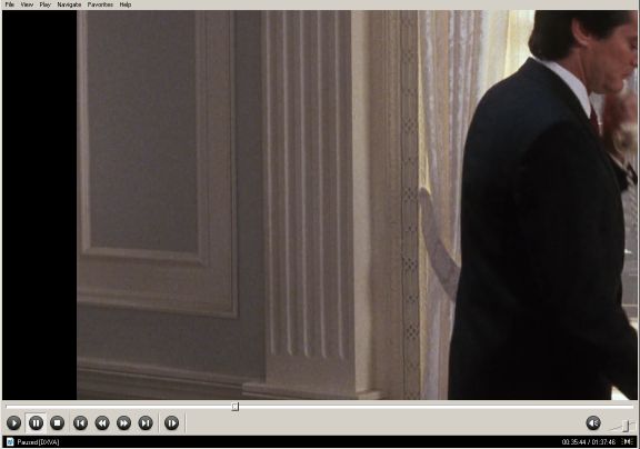

    Here's the effect with MPC-HC displaying a 1080p video in it's native resolution using my CRT monitor. I've moved the video over to the right so you can see a black border on the left where the video ends.

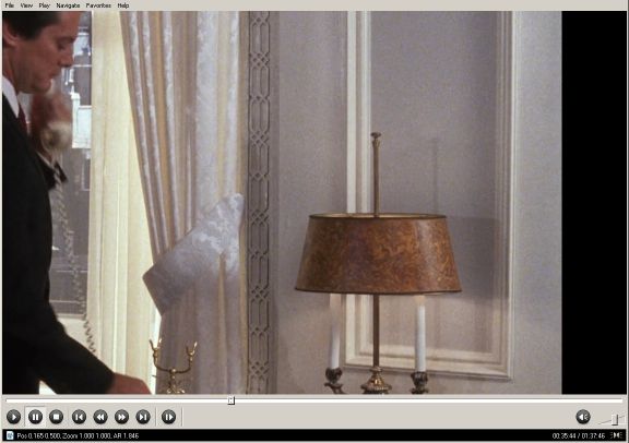

    Same frame, this time the picture was moved to the left.
    Moving the video around that way is probably much easier than trying to drag a window around when it's a lot larger than the size of the display. I can't remember, but I think I might have mentioned how annoying that is.
