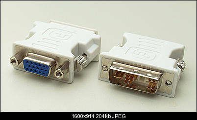

    Part of the DVI spec means it can carry the analogue (VGA) signal as well as the digital signal if the right type of DVI connector is used. Most/many video cards with DVI connectors output analogue this way, which means you don't need a converter to connect using VGA, just a DVI to VGA adaptor. Something like this:
    They used to be supplied as standard accessories with video cards.... I still use a couple and I've got a few lying around, but maybe manufacturers don't include them with cards much these days. Anyway, if the video card has a DVI out you could probably try VGA using an adaptor.
