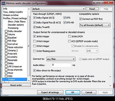

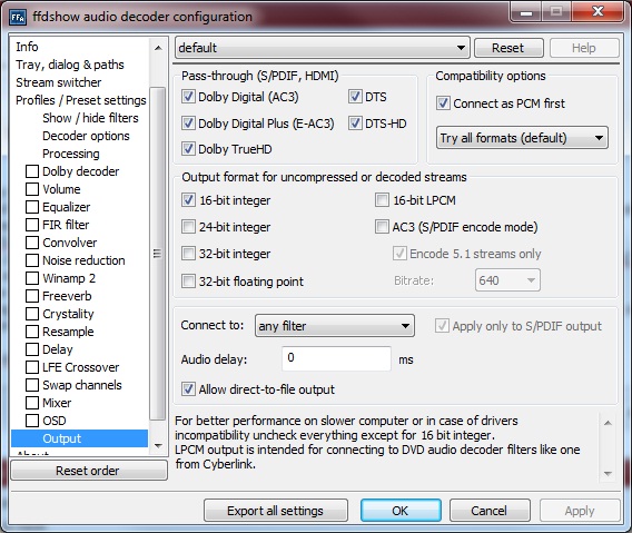

    I tried uninstalling FFDShow, playing a movie with a DTS-MA track, and nothing changes. I installed the latest version, and I have passthrough enabled for all the formats as shown in the screenshot, and same result:

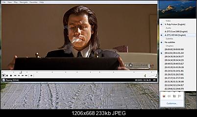

    I tried using the Haali Media Splitter, and selected the DTS-MA track, and nothing changes either.

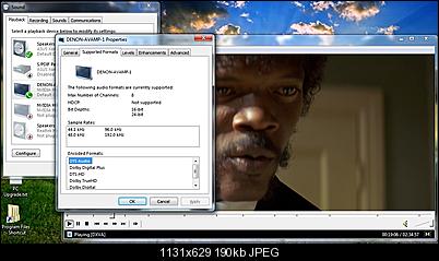

    It shows that my receiver supports the formats:
    What else do I need to configure?? I figured it would just be plug and play.

    I don't know what ffdshow means when they say "DTS-HD". This could mean that they actually only support DTS-HD High Resolution audio, which is a slightly different format from DTS-HD MA. If that is the case, then it means that ffdshow doesn't support DTS-HD MA at all except to give you DTS core audio extracted from the MA audio. Again, I am just speculating here, but it does explain what you see.
  4. Member Cornucopia's Avatar
    I'm pretty sure jman98's guess is the correct one.

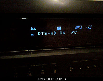

  7. You could try LAV Splitter and enable 'Use DTS-HD framing for all DTS types' in it's audio configuration.
    Canada

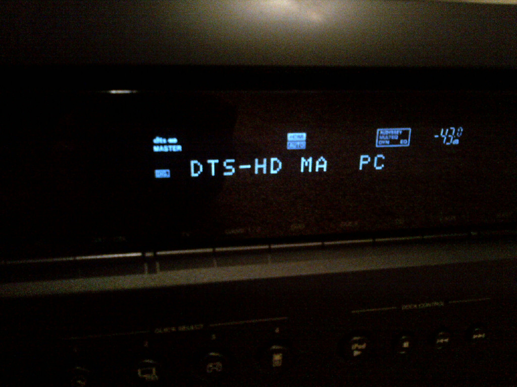

    YES! That fixed it. Thanks! What a pain in the ass.
