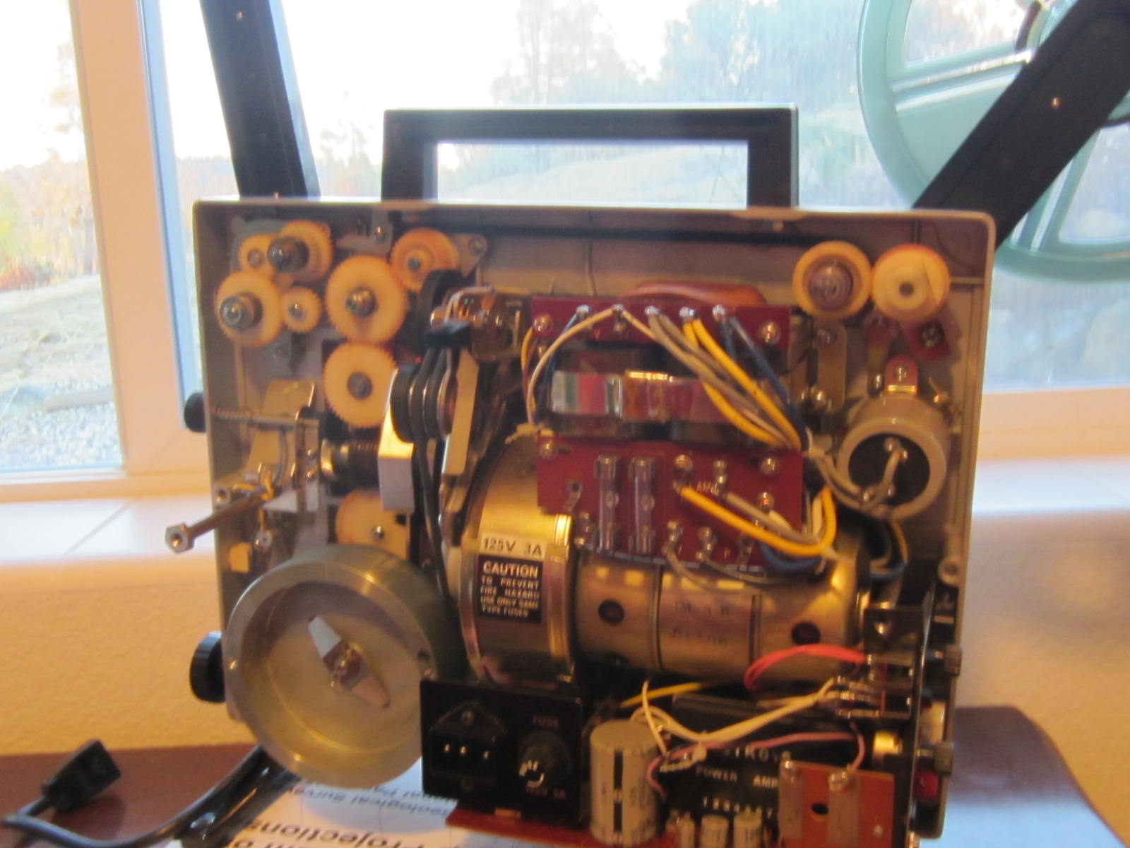

    Definitely off topic, but maybe someone here has knowledge of where I can find a "shop" manual on how to clean my Elmo ST1200D Super 8 projector. It's probably 20 years old and for the most part does work. I had it serviced maybe 14 years ago. It takes a bit of fiddling with the counterweight inside (maybe something else), and it comes to life. If I leave it unused for maybe 20 minutes, it needs help. ( have plenty of respect for the 3 amp current, so am careful about working inside with eraser pencil.)
    I'm adding a pic here to see if that's helpful.
