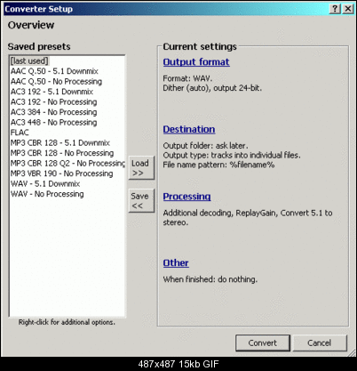

    For Foobar2000 I use the following settings (from the converter setup window which you open by selecting "..." from the right click convert menu). Click on the title of each to open a new window.
    Output Format:
    Wave (of course you can convert to any format you like).
    Under the output format section, after selecting "Wave" you can select the desired bit depth using the drop down box at the bottom of the window. If you leave it on "auto" I think it'll default to 16 bit for lossy sources. I select "lossy sources only" using the Dither drop down box. Once that's done use the Back button.
    Destination:
    You can set it up however you like but I use:
    Output Path = "Ask me later"
    Convert each track to an individual file.
    Name format = %filename%
    Once that's set up, use the Back button again.
    Processing:
    Click on the "Convert 5.1ch to stereo" DSP in the Available DSPs list on the right and use the arrow to add it to the Active DSPs list on the left.
    Click on the box next to the ReplayGain section. Choose Source mode = Track, Processing = Apply Gain. Under Pre-amp move the "Without RGain Info" slider to -6db.
    (The above won't apply ReplayGain as dts files won't have ReplayGain info, but it'll get Foober2000 to drop the volume by 6db while converting. That should ensure mixing the 5.1ch audio to stereo won't cause clipping)
    Once you've set up the above use the Back button again and save the conversion as a preset, then next time you convert you can just select the preset from the right click convert menu. The converter setup window should end up looking something like this (minus my saved presets).
    If the resulting file size is over 4GB try using wave64 as the output format instead of wave. I'm pretty sure eac3to will also output to wave64 (I think you need to use W64 as the output format) but I can't vouch for programs being able to open wave64 files.
    You can find the command line syntax for eac3to here, along with an explanation of what each does: http://en.wikibooks.org/wiki/Eac3to/How_to_Use#Command_Line_Syntax
    The ones you probably want to add are -down2, -mixlfe (optional) and -normalize.
    In theory the eac3to method is better than using Foobar2000 as it'll normalize the peaks to 0db and it detects and prevents clipping, but I use Foobar2000 for converting regularly, especially for straight 5.1ch to 5.1ch, or stereo to stereo conversions, as I prefer not to "normalise" the volume.

  5. I made a few edits to my above post and added a pic to help you, but anyway......
    The ReplayGain options are designed to use ReplayGain info saved to files, so you can use foobar2000's ReplayGain scanner first but I don't know if it can save the ReplayGain info to DTS files. I've never tried it.
    The problem is the ReplayGain "prevent clipping" options rely on using ReplayGain tags saved to the files to prevent clipping but I think it's applied before downmixing, so the downmixing could still cause clipping. After lots of testing I've decided applying a -6db gain when downmixing will prevent clipping and generally the peaks will end up somewhere between -6db and 0db. That only applies to downmixing original DTS or AC3 audio etc though. If you downmix 5.1ch audio which was normalized when it was originally converted from DTS or AC3 (ie some of the AAC audio in downloaded files) then it might require a couple more db of gain reduction to prevent clipping.
    The reason for choosing "track gain" and "apply gain" as ReplayGain options when downmixing is not to use ReplayGain, as the DTS audio won't contain ReplayGain info, but simply because without it the setting to adjust the volume won't work. You need to tell Foobar2000 to look for the ReplayGain info first by setting the ReplayGain options, and then tell it how to adjust the volume when it doesn't find any.
    Hopefully that makes sense.
