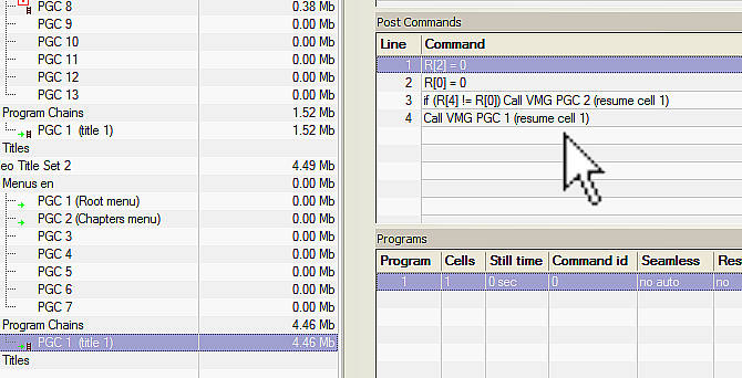

    Here is your fix.
    Chenge "EXIT" command to what you see in the picture, it should work. EXIT comand will do what you see now.

  6. I'm about to try that, tinker, thanks! Will it work for the trailer included too? It does the same thing.
  7. Oh, and where can I find the "Call "root" menu (resume cell 1)" option? I'd guess selecting Jump/Call instructions would give that option, but it doesn't...
    Oct 2006
    Canada
    Double click on "EXIT" command. New window will open, see first picture . For Trailer you need to go to WMG PGC1, see picure second picture.

  9. It worked for the main feature, but not for the trailer. Maybe the parameters should be different?
    Oct 2006
    Canada
    I assume that the trailer is in VTS2 PGC 1 (title 1), because that where it leads when I click on Trailer button.
    Did you put (Call VMG PGC 1 (resume cell 1) command in there instead of EXIT command.
    I tried Debug in Remake and PgcEdit and both work fine with those commands.
  11. Oh, I made it work now. I foolishly applied the same parameters to the trailer than to the movie (menu type #3 instead of #1). Thanks a lot for your help!
