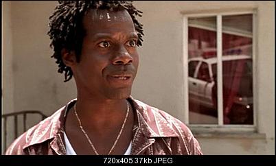

  5. I attached a screenshot (sample.jpg) of movie "Men at Work" rip when played with WMP on my PC, and it does the same thing. You'll notice the small bars on the top, bottom and right side. It does the exact same thing on my other PC (designated HTPC) too. I've read about overscan, but not sure if this is the problem. There's no option in WMC, that I am aware of, to zoom, only change aspect ratio, which is meant more for 4:3 ratio broadcasts than widescreen. I'd hate to think I'd have to crop every DVD I rip, but if others have the same problem and that's what it takes, then I'll do it - just want to make sure I'm headed down the right road before investing the extra time it takes.
    Not sure if it matters, but I'm using HDMI out from the HTPC directly to the 46" Sony Bravia. I couldn't find an option on the Sony for auto zooming either.
  6. The only way to know for sure if it's because of overscanning (or rather the lack thereof) is to play the original disc using the PC. It should display exactly the same way as the ripped version. I suspect it will. The small black bars in your screenshot don't appear to be anything out of the ordinary to me (I'd be very surprised if the original disc doesn't display the same way using the PC).
    Although your screenshot is 960x540, not the original DVD resolution (720x576, 16:9, I assume). I gather that's simply because you resized the screenshot for posting?

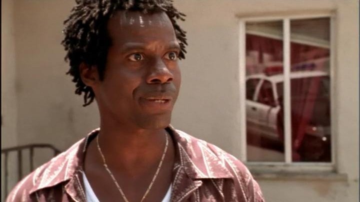

  9. Typical DVD video with thin black bars down each side. And maybe a 1 pixel black line at the top. It's a bit hard to tell.
Name:	0101 Pilot.mkv_snapshot_23.26_[2012.12.19_19.12.50].jpg
