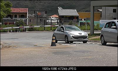

    Hi,
    I'm new here. But I expect to contribute a lot with this forum. And also expect your contribution.
    I'm working with computer vision in a Brazilian University.
    My work consists in recognize license plates, based in tracking, trying to improve the acuracy of some methods that try to do that.
    I get a Panasonic HDC-TM80, that is able to record videos at full hd resolution (1920x1080).
    But I need to load this videos in opencv, so I need them in avi. I can't do a good conversion! I always get a noise in moving objects, and that's horrible to my propouse.
    I have checked this thread: https://forum.videohelp.com/threads/285841-How-to-covert-from-mts-to-avi-or-wma
    But, unfortinelly, nothing seems work to me!
    My last try is attached.
    Someone have some idea of what can I do?
    Thak you very much!
  2. You just need to handle your video as interlaced. Each frame consists of two half pictures, one in all the even scan lines, one in all the odd scan lines.

  4. You could perform a smart "bob" and make a double frame rate AVI file. The best smart bob deinterlacer is QTGMC() in AviSynth. Second best is Yadif() in AviSynth or VirtualDub. But you may find that a simple bob (Bob() in AviSYnth, BobDoubler in VirtualDub) works better for your purposes. The smart bob algorithms may have trouble with small text -- like the license plates in your image.
    Does your camcorder have a progressive mode? That will eliminate the problem at the source.

    Qtgmc usually works much better. It analyses the motion over multiple frames to build the output images but I only had a single frame to work with. With the actual video it should work better.

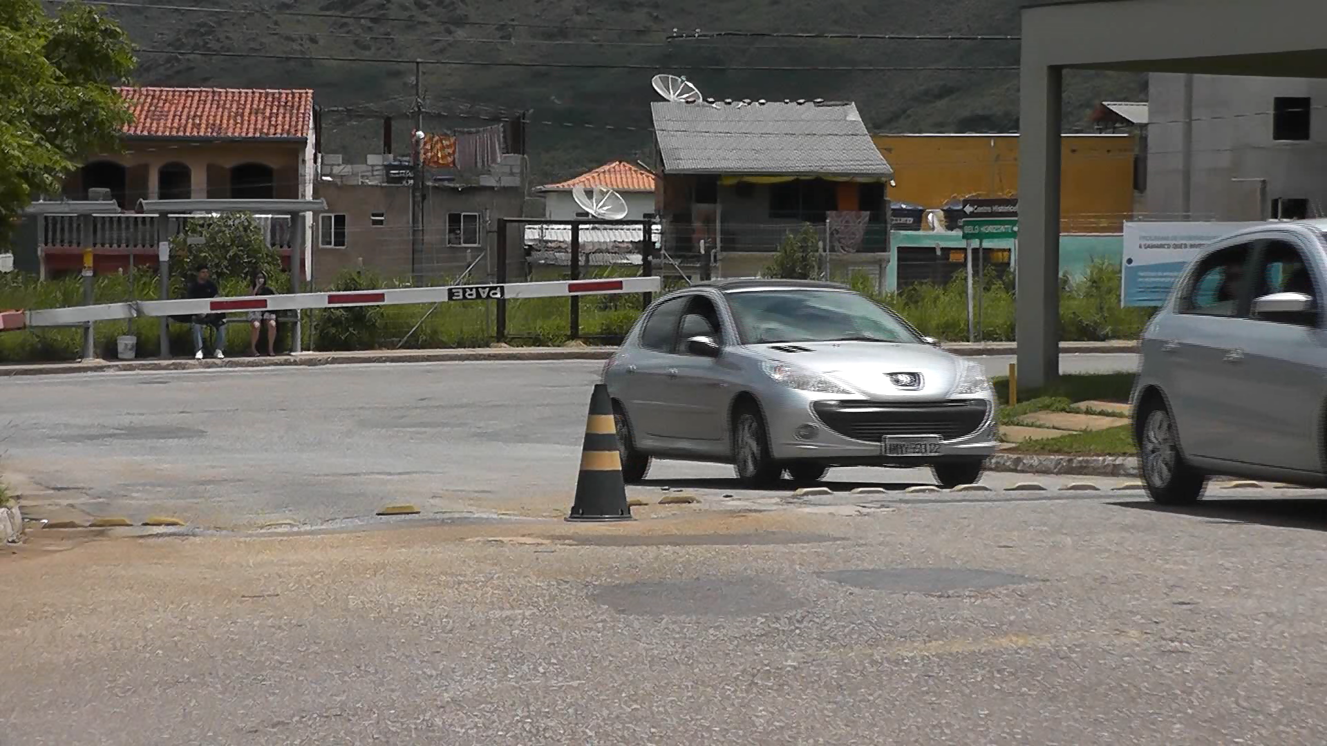

  9. QTGMC() + McTemporalDenoise():
