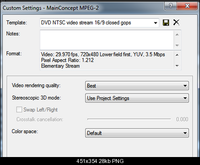

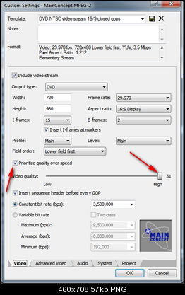

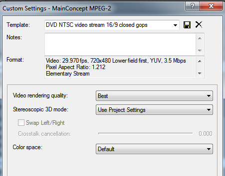

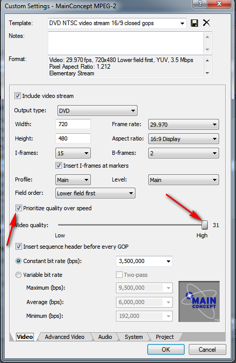

    make sure the encoders settings are all on highest quality. that encoder does a fine job if set up properly.
