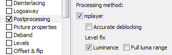

    Hi,
    You probably used the ffdshow luminance fix...

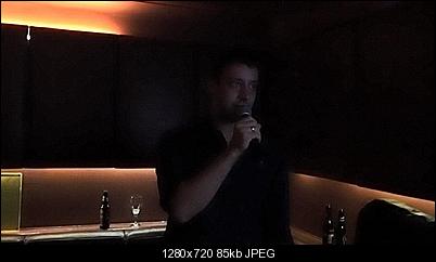

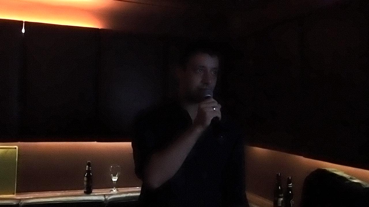

    It's quite neat and the result is great (it automatically adjusts based on the video itself). The result looks like this:
    FROM:

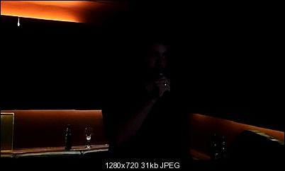

    TO:
    I tried using VirtualDub, but people around here say that I can't apply the Post-Processing filter (until now this seems to be true)
    I also tried using MeGui and StaxRip, but reading documentation didn't helped me much...
    How
    can I get this into my encoded video?
    I would gladly consider any of your suggestions...
    Best regards

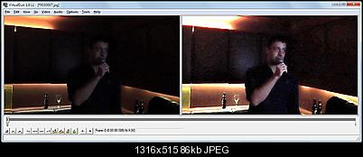

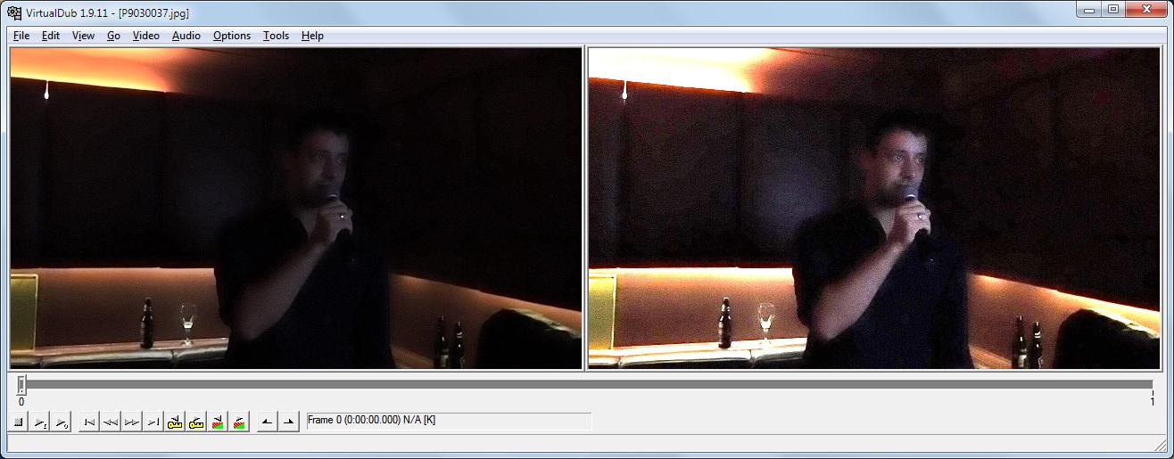

  2. Try this: In VirtualDub add the Brightness/Contrast filter first. Bump up the Brightness by one notch (~7 percent). That filter works in YUV so you can bring up the brightness before it's lost in the YUV to RGB conversion. Then you can use any of the other filters. Use the Levels filter to adjust the levels.

    jagabo... you took the wrong image (the already processed one). If you try to apply the brightness/contrast filter over the original image, you will see that you can't really do what the post-processing rule does

  5. Originally Posted by veverone View Post
    No you misinterpreted what I was showing. As you found, there's no way to restore the darks in your darker image because they have already been lost by your processing. Using VirtualDub's Brightness/Contrast filter first will give you something like your lighter image (ie, you can duplicate what ffdshow does). So I started with that image. Then you can use the Levels filter to further adjust it to get something like the output I showed.
