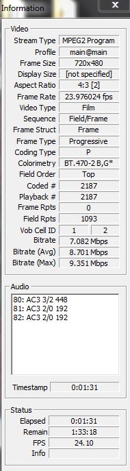

  12. ok so im pretty sure the pattern is consistent correct me if im wrong
  13. You can just open the D2V, look at the bottom and it'll tell you if it's 100% film or not.
  14. i cant tell it just says film

  15. Read what manono said: the d2v
    ie. open the d2v with something like notepad or wordpad, go to the bottom

  16. Yeah, at the bottom of a D2V, it might say:
    FINISHED 100.00% FILM
    if it's all film (encoded as progressive 23.976fps with 3:2 pulldown). However, if you watched the Preview all the way through and that's what it says, it's the same thing. But you didn't, as you took the pic at 1:31 into an hour and a half long video. Making a D2V is way faster than watching the Preview. You can speed up the Preview, if you like, by going Options->Playback Speed->Maximum.
  17. the entire video 99.94% film
