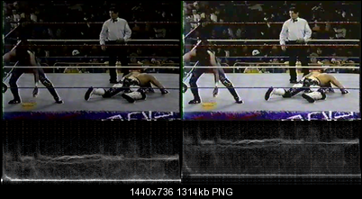

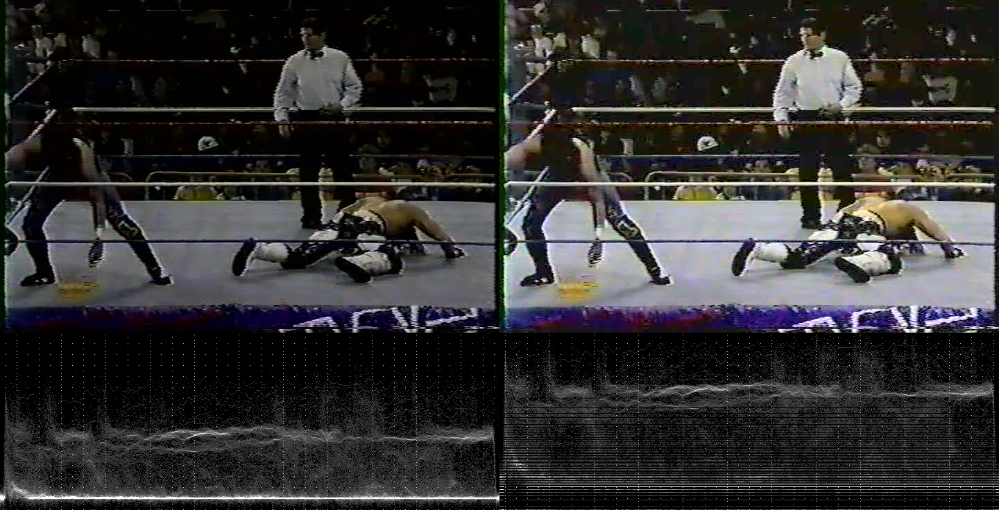

  7. Start with something like this, tune to your liking:
    ColorYUV(gain_y=75, gamma_y=200, off_y=-14, cont_u=200, cont_v=200)

    @jagabo, yep I was about to suggest something similar. And, yep, what's down there in the crushed darks is mostly the same noise I saw on my monitor.
  11. Yes, the darks are crushed beyond repair. And when you lighten the darks the macroblocking and posterization artifacts down there become visible. VideoFanatic will have to decide for himself how far he wants to go.
