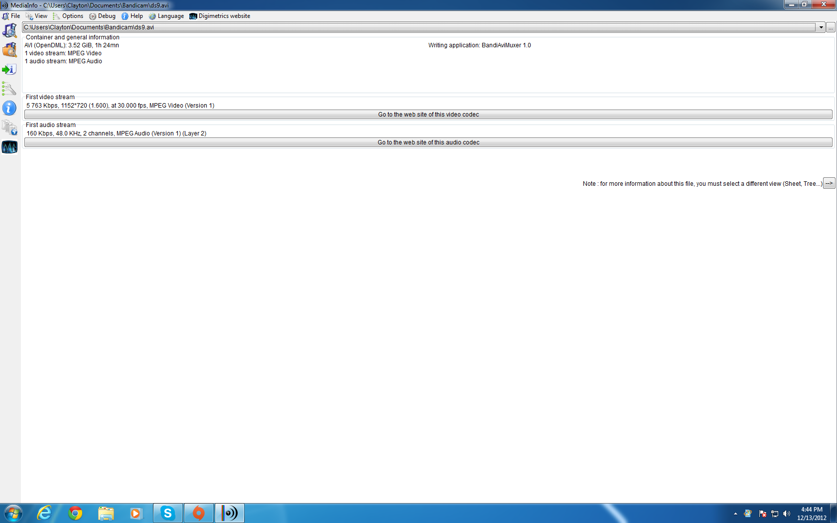

  3. heres a sc

    It looks like MPEG in an AVI container.
    If you click Start > ffdshow > VFW Configuration, under the 'Decoder' tab, scroll down to 'MPEG in avi' and enable it.
  5. Member Cornucopia's Avatar
    You've got MPEG1 video + MP2 (Mpeg1Layer2) audio inside an AVI. Very NON-standard. Use something like AVIMux-GUI or AV Splitter to demux to raw/elementary streams (you'll get an *.M1V and an *.MP2 file).
