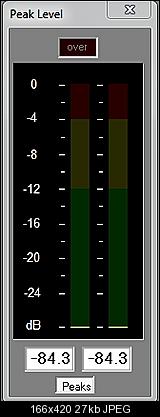

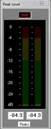

    The methods mentioned above are all good, but I have run into problems where Media monkey , audacity, etc when measuring volume of the audio portion of some VIDEO files. I use a manual method that unfortunately needs to have each video tested separately, at least a portion of it but This is not much of a problem for me since I just test the next file while another is converting.

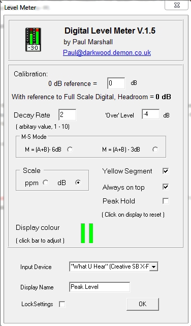

    http://minorshill.co.uk/pc2/meters.html#Digital has many digital meters to use for this process but I use the
    Level Meter with Digital readout for accurate steady state measurements version because it is simple and is adjustable as well as having bars as well as digital readout in 1/10th of decibels.
Name:	ScreenHunter_404 Dec. 13 23.30.jpg
ID:	15191Click image for larger version
Name:	ScreenHunter_405 Dec. 13 23.31.jpg
    Bear in mind that the level displayed also depends on what your volume level is set to, but then again, I am trying to adjust the level to MY needs so it too is not a problem. I just set my player to mid scale and Windows audio to 35. If the sound is low, then I just note the reading on the meter and adjust accordingly.
    This level meter also adjusts for 0 decibel level corresponding to the gauge and has a marker that you can set to freeze at peak audio or allow the marker to reset after a delay which is very handy to measure peak volume. The nice thing about this meter is that is measures the active level of the sound card and does not need a microphone like some.
    This method may be a little slow if you are looking for a large batch conversion process but your problem sounded similar to one I had when converting a few videos at a time or creating a DVD and it worked well for me.
