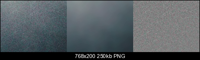

Results 1 to 15 of 15

  4. Run a big Gaussian blur, subtract it from the original, add an offset to restore the average.
    original, blur, subtract

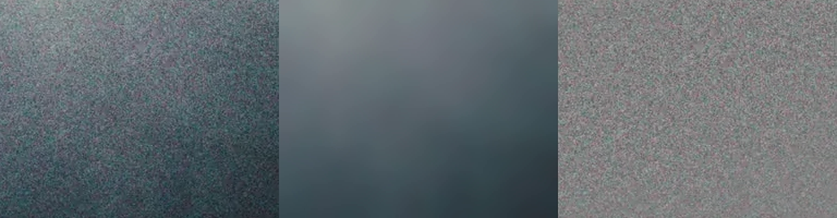

  5. Originally Posted by Mephesto View Post
    Problem with that is, there's a very blurry and not straight line between the bright and dark areas. I can't just select a large area and illuminate with a fixed number.
    It's not a problem - that' s what a "feathered mask" is for . Different values of luminance in your mask represent different transparency values . 100% white (or RGB 255,255,255) is 100% transparent . 100%black (RGB 0,0,0) is 100% opaque. Values in between are intermediate in trasparency
    In the example below, I just quickly "eyeballed" it. If you spent more time I'm sure you can do a better job. Or maybe you wanted it to be the "brighter" section? Anyways, I'm sure you get the idea...
    You know any filter that can separate the chroma from the original so I can add it to the equalized photo?
    In avisynth , you can process chroma separately with utoy, vtoy (u and v planes can be processed separately) . These will represent them as greyscale, then you can do whatever processing on the U, V planes and merge them back into Y,U,V video . Or maybe you want to merge U plane from another video ... you get the idea...
    http://avisynth.org/mediawiki/Swap
    Image Attached Images

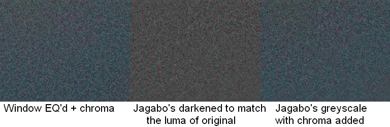

    I couldn't figure out how to separate and merge chroma with the info you gave so I did this:
    equalized=imagesource("C:\noiseWindowEQextreme.PNG").greyscale.converttoYV12
    original=imagesource("C:\noiseEQtest.png").converttoYV12
    b=original.greyscale()
    chroma=subtract(original,b)
    color=chroma.invert
    subtract(color,equalized)
    invert
    Don't laugh. I'm unaware of any "add" function and I forget how to use Overlay.
    Here's the result. I think I like your method better. Mine looks too unsaturated and the localized equalization is too atomic. This is due to the small (16x10) window I set in the tool, because if I set higher then the edges would be too patchy.
    TBH, I think this aggressive equalizing would do more harm than good for the NV noise profile. What do you think?
  7. Originally Posted by Mephesto View Post
    That's pretty good. What did you use to do that? Photoshop? Can you quickly detail the procedure? The word "feather" only brings up memories of trying to make accurate selections of objects that are hard to accurately select. I could never do it right, but all those pros on YouTube could.
    Your photo has a T-shaped bright spot in the middle-right but as you said, you did it quickly so I'll leave that be.
    I did it in AE - It's the most powerful tool for masking manipulations for video by far . You just draw whatever shape you want with the pen tool . You can composite different layers, different masks, variable mask feathering . For example if you wanted to fix the "T" (or any other shape) you just draw it . Photoshop is great for single images, but AE can use "moving masks" or rotoscoping for video
    This looks ok. So I assume you did want the "dark" instead of the "bright" ? You can play with the saturation if you feel it's undersaturated (just add saturation filter, e.g. tweak(sat=?) )
    I dont know, I never tried this approach in NV before. You'll have to do some tests - the proof is in the end results . It looks like the noise pattern might be "flattened" a bit ?
  8. Originally Posted by jagabo View Post
    [Attachment 15124 - Click to enlarge]
    I can't believe I missed jagabo's post. This is a damn good idea. Isolating the noise from the luma since noise is in the higher frequency. Why didnt I think of this...
    What script/filter did you use for the Gaussian blur?
    This is perfect. Your method returned the best result.
    PDR, look at the first and third image. Do you see what I meant by the equalization being too atomic? It destroyed the smallest luma irregularities in the noise when I only intended the large ones gone. I'll do NV video tests later and post screenshots if anyone's interested.
    First I tried something like 50 Blur(1.0) but I didn't think that was blurry enough. So I used the Gaussian blur in a paint program, radius 15. You should be able to use VariableBlur() in AviSynth.
