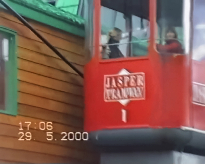

  17. I have worked a little on this nightmare-of-footage for the fun but try to get a better copy really, see below
    processed video sample:http://www.mediafire.com/?viwzuo4ob8yo344

    Yes, that's about what I was getting. It's a bit bright. The start is the easy part. Wait until you get to frame 80.
