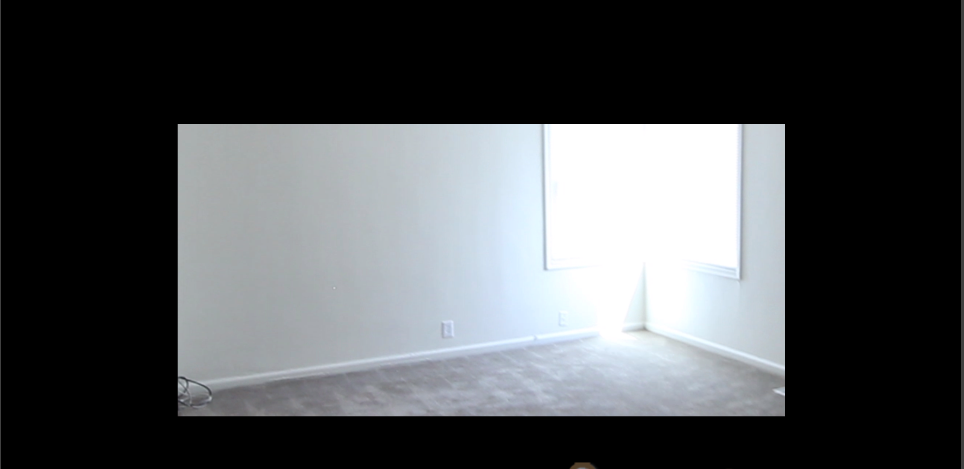

    Similar problem but Different. Does this happen to anyone????
    I analyze the footage and it works for a sec then large balck boarders appear around the footage cropping most of the image. I shot the footage with a steadi-rig and my 60D and it looked pretty good but for some reason this happens. Is it a premiere bug??? Plus I can used the stabilizer before no problem with the same set up.
    Please, HELP!

  21. Originally Posted by dn8lane View Post
    Then please start a similar but different thread.
    One or two big bumps could easily result in those borders if you leave the effect in it's default Stabalize, Crop, Auto-Scale settings. You have to twirl down the options and play with the parameters until you find something acceptable.
