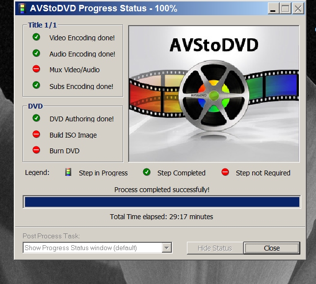

    Well. It still not have audio and the disc had just some data on it that would not open in the DVD player but I looked at it on the computer and there was a media file that also would not open.
    So I decided on another film and that also ended up as unreadable file on disc. At this point I looked the TS folder and it looked OK so I decided to burn it with Pinnacle Studio. End IT WORKED.
    Here is the Log file and a screen shot of the end screen.
    The end screen I find strange since I did set it to burn disc but it indicates otherwise also the Mix Video and Audio has red button on it.

  14. But you have NOT selected 'Burn DVD' in your AVStoDVD project... how can you expect to have a playable disc? The disc will be empty or, if RW, it will contain the last recorded data.
    Anyway, if you are happy to convert and author with AVStoDVD and burn the DVD folders with Pinnacle Studio, I'm happy too.
