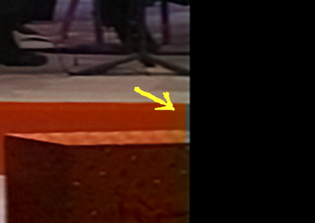

    I notice that when using the resize filter to set a 4:3 image inside a 16:9 image with pillarboxing, there's an issue with the right side of the image. The color is missing from the part right up against the border.
    Anyone familiar with this and how it can be cured?
    Thanks.

  2. Was the chroma shifted earlier in the process, as is often done with VHS caps?
  3. Use mod4 (or larger) frame sizes.

  8. Member brassplyer's Avatar
    Apr 2008
    Not earlier in the chain but after - the chroma shift appears to be what's causing it. It appears every other frame.
    It doesn't appear I can just crop it out either, when I crop that edge, the problem area just moves over.
  9. Originally Posted by brassplyer View Post
    Well then of course you're getting the discoloration. You're shifting gray chroma from the black borders onto the picture. Perform the chroma shift before adding the borders.

  11. If you shift "black" chroma over onto the color picture you will be left with a greyscale picture.
  12. Member brassplyer's Avatar
    Apr 2008
    The filter addresses chroma I and Q, which is the black chroma?
  13. Both I and Q from the black borders will both have "gray" chroma values (128). When you perform a chroma shift you are moving the colors (to the left in this case) but leaving the luma (greyscale) picture in place.
  14. Banned
    New York, US
    I keep looking at the image in post #1. Why did it "gray-out" only a portion of the lower part of the right border, but had far less effect on other parts of the same border?

  15. Member brassplyer's Avatar
    Apr 2008
    Dunno. If I kill the chroma shift filter the issue goes away. I may just live with it without the filter since the chroma issue isn't terrible particularly with the color noise filter that's also in the chain. And I think I may not even be accurately identifying the issue, maybe not shift so much as bleed.
