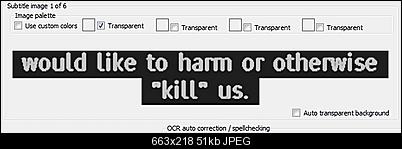

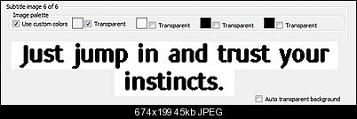

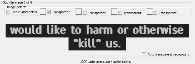

    Subtitle edit seems to be the best that I found but be sure to change the settings for the colors. That can make a big difference.
    The normal default is usually:
Name:	ScreenHunter_448 Dec. 22 12.21.jpg
    But I find you get much better results, especially letters that abut with these settings but try variations:
Name:	ScreenHunter_448 Dec. 22 12.23.jpg

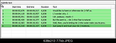

    Even the adjoining letters in "otherwise" above render as below after changing the settings.

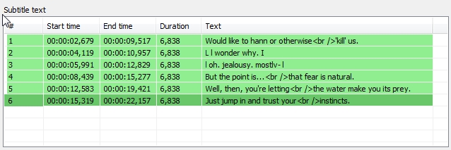

Name:	ScreenHunter_449 Dec. 22 12.23.jpg
    Dec 2012
    Toronto
    It says harm not hann. Seems to have a lot of OCR mistakes.
