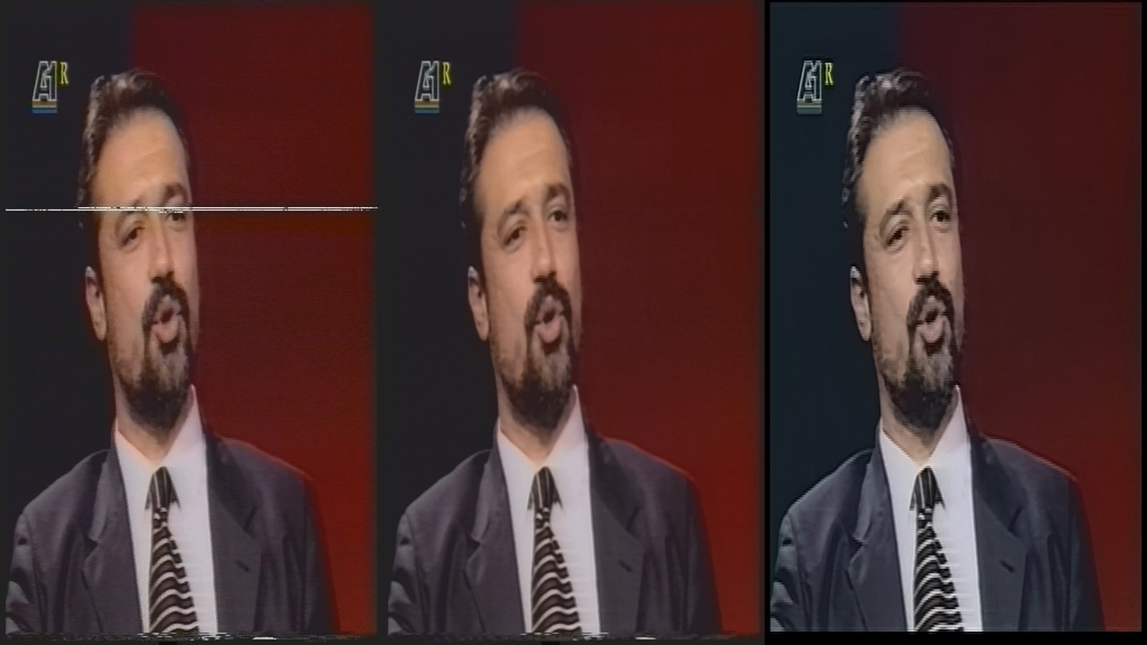

  7. It's not bad but not better than what i did and the colors are way off. It would be worth to try your script without neat or msu smart sharp and rgb convertion to see.
    If you zoom-in you can see a problem on the fields (more obvious on the logo part)

    Thanks to poisondeathray for passing on the script and to theMaster1 for mods made to it. I'll understand it one of these days. Does a lot of fixing, even if frames 55-56 have a streak and there's some frame hopping. Every clip lately has been a learning experience.
    This script and Didee's original version are giving me a VirtualDub error several times during the run:
    "Internal error: SSE state was bad before entry to external code at", the "at" followed by references like:
    "\source\w32\videocodecpack.cpp:158", "\source\AVIReaderHandlerTunnelW32.cpp:153", and a couple of others. The VirtualDub forum has old posts advising to ignore the error -- which I did, and the results look OK. Can't say I've ever seen that one before.
    In any case, still playing with this one. The color and levels are a problem. And whatever happened to the detail in the guy's shirt collar? Looks like a levels problem somewhere along the line in earlier processing? Those fuzzy lines and edges in the original are giving me fits. Anyway, I'm still at it.

    Wow--What a problem child this video is! I think the color/levels/dark blocks in the beard are the worst. Got it somehwat more stable now, thanks to pdr and theMaster1. Pulled so many tricks I don't even remember what I did! ReplacedFramesMC helped a bit with 6 frames. Not real happy with it, but for what it's worth.....
    [Attachment 15166 - Click to enlarge]
    http://dc206.4shared.com/download/GGGLBS1x/branco_ccd2.avi
    That troublesome background. Unfortunately it'll come right back as blocks and grain when it's encoded. Gotta learn to use the dither plugin.
