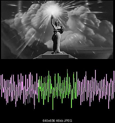

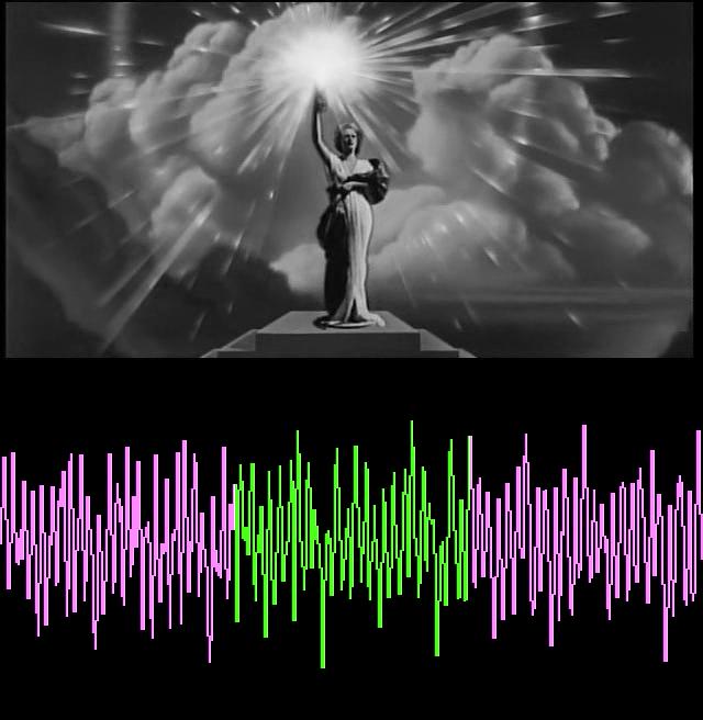

  3. There are AviSynth filters that can remove identical frames but they are not sensitive to audio. There's another filter which draws the audio waveform onto the frame. Putting those together you may be able to come up with something. Here's a start:
    AviSource("video.avi")
    ConvertToYUY2()
    AddBorders(0,0,0,height*2) # triple the frame height so AudioGraph() doesn't write into the picture
    AudioGraph(last, 1) # draw audio waveform in the middle of the frame
    Crop(0,0,-0,-height/3) # remove bottom 1/3 since it's all black
    # Figure out how to remove duplicate frames here....
    Crop(0,0,-0,-height/2) # remove the drawn audio waveform, leaving just the original picture
    A sample frame before the final crop:
    Silent frames will have just a straight line across the frame.
