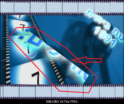

    I created a opening to my movie.
    This is my problem:
    this is the video:
    I used BCC 3D SHUFFLE
    Why did this happen?
    How do i fix it?
    EDIT:
    it is at SONY VEGAS 11

    Which "thing" are you taking about? There are many things going on here - Some I find acceptable, some not.

    the text is cut off.
    Films up and down is something I did in Photoshop to match the opening video to 4:3
  4. Looks like a poorly designed plugin/effect . What you are seeing is a layer edge . It even cuts off the previous layer
    I don't use BCC - Are there any settings you can adjust in the plugin options ?
    I hope this is the trial version and you didn't buy the package...

    When you change the perspective on a plane layer, the image gets distorted because the z-depth can get too deep. Resize the image to accommodate. Use track motion. Solo that track to see better.
    Also, make sure the animation is on the top layer. Maybe the edge of the other text is overlapping it?
    Are you using PNG with transparency? Or masking? If masking, don't do it that way.
    BCC is a ripoff. You get a few decent tools, but a lot of old junk. Use the 3D Track Motion tool in Vegas instead.
    Here's an example. Try it, it's good. You can do whatever you want, like BCC.

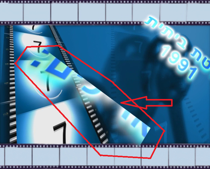

    The "3D Shuffle" effect is designed to shuffle whole frames, and doesn't recognize the alpha channel, or anything else. It simple uses the 3D Track Motion tool. Basically it flattens the frame, even though there is nothing to flatten.
    You need to animate the text via the "Text Box" keyframes where you made the text, and in conjuction with the "3D Track Motion" tool. I'm going to rework it the correct way.
    Here, the red box indicates the flattened area.
    Wow that really sounds like a rip off. What a crap plugin
    Hahaha, you have to just do it differently. And it's not a "plugin" per se, it's one of the canned pre-built transitions. It's for "transitioning", not compositing. Two different birds.
    You can see here at the intersections there is transparency. What I did was make a "snap" of the text, then brought it back in and composited three tracks. Pretty simple. I overcomplicated things up above, but meh, maybe useful to someone else.
