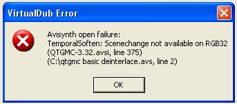

    As suggested I downloaded QTGMC for Avisynth. As far as I know I have all the needed elements.
    When I try to run it on a Huffyuv test file I get the error shown. Also including a shot of my plugins folder to confirm I have what's needed.
    This is the script I'm using
    AviSource("e:\test segment.avi")
    QTGMC ( Preset="slow" )
    Thanks for all assistance.

  2. ConvertToYV12(interlaced=true)
    Post your avs script
    It should look something like
    AVISource("video.avi")
    QTGMC(preset="faster")

  4. So does it work now? If not, post the error message
  5. Member brassplyer's Avatar
    Apr 2008
    Your script works, why doesn't the original? It came off the Avisynth.org site.
  6. Your script works, why doesn't the original? It came off the Avisynth.org site.
    Because your source video wasn't in YV12 (Y'CbCr 4:2:0 planar) . Some filters require certain colorspaces or models. The clue was in the error message (mentioning RGB32)
    There is a QTGMC variant that can work in YUY2 (Y'CbCr 4:2:2), but it's slower and requires some fiddling with specific dlls
    What is your source video, and why is it in RGB?

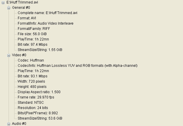

  11. Member brassplyer's Avatar
    Apr 2008
    This is the mediainfo output.
    Maybe describe in more detail the steps prior to this stage
    After capturing DV via firewire passthru from a Sony Digital8 cam, I then re-saved it as a HuffYuv file, not RGB. Chose Huff Yuv from the codecs in Virtualdub and saved it as avi.
Name:	huff file media info.jpg
