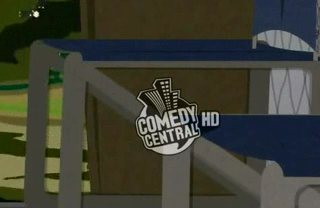

  8. Damn I typed out a message but it got lost. Short story: this failed horribly like I knew it would. The area filled was jittery.
    The logo is not opaque though. Here's a screenshot. What logo removing tool should I use?

    I think I have a workflow now.
    Start with the offensive logo. Note that it's the typical 50% white transparency type.
    Select the logo using color tool in additive/contiguous mode, and fill it with white
    Duplicate the selection onto a new layer
    Composite with these dodge/burn settings, and voila!
    This method can be translated into video tools, and should act as a "content-aware" solution. The matte must fit the logo exactly to work, so bring it in as a PNG with transalpha.

  18. Pixelated? This is a 720p source. It doesn't get better than this.
    It's been sooo damn long since I did logo removing. Last time was around 2008 and the most impressive results I've achieved was alpha-blended logos with this filter albeit with a lot of (tolerable) artifacts.
    I've given up logo removing because it was obvious it didn't work and MSU told me they weren't gonna work on a better, motion-compensated one for a long time.
    I've noticed they finally did release a new version recently but I couldn't get it to work. I'm getting a black output on the second (removal) pass. The manual even said for some reason that the first 1800 frames will be blank but only if you're removing animated logos. I even tried to work on 2500 frames to see if the last 700 would not be blank. They still were.
    Here's a video sample of the logo.

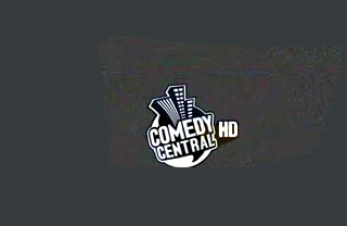

  19. So I tried to isolate the logo, which I did, and then subtract but this isn't working. The chroma shifts depending on the scene. No idea why. I tried shifting the brightness of the logo but this seems to have more to do with contrast. Ugh.
    Ridiculous.
    Image Attached Images
  20. The alpha blended logo is added to the base image (except when the logo fades in) with a simple algorithm like:
     output = (original+logo) / 2
    You can generate the logo by subtracting a clear frame from a logo'd frame.
    DirectShowSource("s14e6.mp4").ConvertToRGB()
    Merge(SelectEven(), SelectOdd()) # temporal filter for noise reduction
    Subtract(Trim(last,10,0), last)
    Cleaned up and contrast stretched:

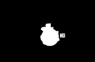

    Hand edited to make an alpha mask:

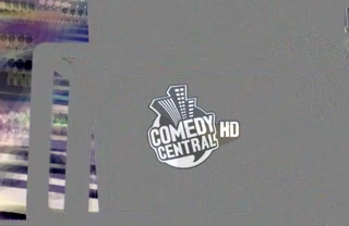

    Sanity check, frame 0:
    ovr=ImageSource("logo.png")
    mask=ImageSource("alpha.png")
    Overlay(last, ovr, 0, 0, mask, 0.5)

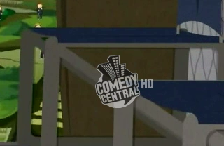

    very close to frame 50 of the original video:
    Once you have the logo you can reverse the process.
    output * 2 - logo  = original
    I'll work on that later...
  21. Yeah, that's what I did. I subtracted frame 50 from 0 since it was the same scene with and without the logo, then I saved the subtracted image, editted accordingly and then subtracted the whole video with the subtraction containing the isolated logo. It worked perfectly only on that specific scene. It screwed up on the next. The chroma seems to be non-linear. If I subtracted from a scene with an orange background, the isolated logo would have an orange tint (blue actually since it's the opposite color).
    I just ran grayscale() on the logo I isolated from a scene with a uniform orange background by photoshopping the logo out and subtracting and now I have a more neutral logo but the contrast is still off. The result is what you see in the screenshot of the guy in blue pants.

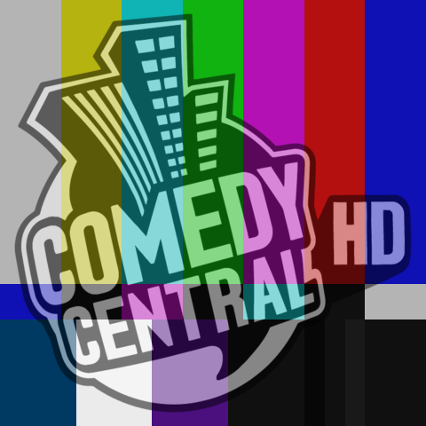

    In theory this should work. I think the problem is 8bit avisynth is clipping values when you do the output*2 step (or you can use "add" as an operator to itself) . values > 255 for R,B,G will clip to 255 . Unless you know away around this ?
    The "black" overlaid areas are returned to almost normal , but I think the "white" overlaid areas were clipped in the calculation. I think the "almost normal" discrepancies in the "black" overlaid areas might have to do with avisynth using YUY2 internally for Overlay() - I remember gavino saying something about that . Using pc_range=true doesn't help . Or it might just be rounding errors. I think Layer() might be able to work in RGB natively, but I can't find operators like add, subtract . Or maybe this can all be done in masktools in YUV ? They have all these polish notation and operators, I'm not too good with the programming side...
    e.g.
    If the original "red " patch was RGB 180,17,17
    The White overlay areas on the red patch is RGB 216,134,134
    The Black overlay areas on the red patch is RGB 90,8,8
    A 134*2 step will give 268
    A 216*2 step will give 432
    bars=colorbars(480,480,"RGB32")
    logo=imagesource("logo.png",pixel_type="RGB32").bicubicresize(480,480)
    Overlay(bars, logo, mask=logo.ShowAlpha(), opacity=0.5, pc_range=true)
    #logo
    output=last
    overlay(output,output, mode="add", pc_range=true)
    output2=last
    overlay(output2,logo, mode="subtract", mask=logo.ShowAlpha(), pc_range=true)
    (I didn't limit the "fix" with a mask, so ignore the outside areas)

    You would do it like this:
     (output - logo/2) * 2 = original
    I think you can also use masktools which, if I remember correctly, works with more than 8 bit internally.
    By the way, VirtualDub's Delogo tool has a deblend mode for just this type of logo.
    I cheated "*2" by adding to itself . I don't know how to do a pixel mulitplier, and my masktools knowledge is rudimentary - do you want to see if you can figure it out ?
