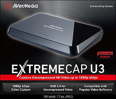

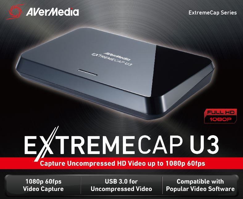

    AVerMedia C877 (no price or date announced):
    http://gamerzone.avermedia.com//game_capture/extremecap_u3
    http://maxlevel.org/avermedia-reveals-extremecap-u3-capture-device/
    ExtremeCap U3 is an USB 3.0 capture card that is truly capable of recording and streaming 1080p 60fps gameplay via HDMI and component inputs. Beyond that, this capture card supports capturing HD raw data to popular video software with its DirectShow compatibility. Simply connect it with your game console and an USB 3.0 PC/ laptop, launch the video software you love, and you are ready to record or share your splendid gameplay footage.
    18Mbps MP4 sample (oddly encoded using VFR...):
    https://docs.google.com/uc?id=0B2B00qZvvJbNc0E2Z29MeGZqV0U&export=download
    This could be interesting. They don't mention whether the audio is multichannel, so no doubt limited to 2ch.
    [Attachment 20275 - Click to enlarge]
    Direct USB Power Supply??
    All Aver cards are below $200.00
    Claudio

  21. Originally Posted by vaporeon800 View Post
    First I was exited, but then I read the specs.
    30mbit/sec max, YUV4:2:2
    Thanks, but no thanks.

    Which part is the problem? They say uncompressed, so the 30Mbps limit is just for their own software. Do you need RGB for some reason?

    The ExtremeCap U3 (CV710 / C877) is out there now ($180 MSRP).
    Newegg ($170)
    Press release: "AVerMedia Unveils ExtremeCap U3 for Uncompressed 1080p 60fps Video Capture" (2013-12-02)
    Regular site product page
    GamerZone product page (nothing new here)
    For some reason Aussie reviewers got samples first..? I suppose due to the proximity to Taiwan.
    There are some others on YouTube, as well as the AVerMedia Lab channel.
    Where the hell is the download for the USB 3.0 Diagnosis Tool? Having it included with the device is nice and all, but sort of pointless if I can't check whether my motherboard is compatible before purchase.
